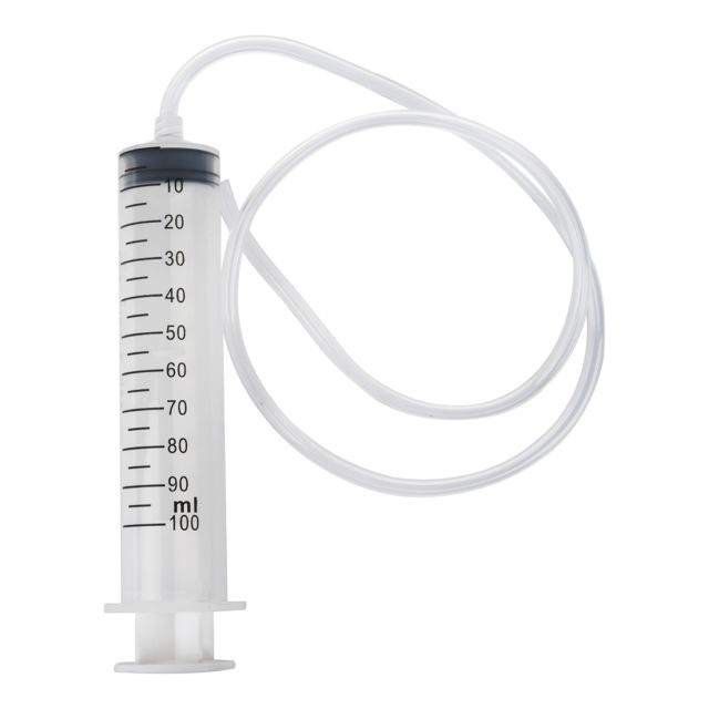

Try to use a single-use syringe 100 ml, (the biggest one you can get), for the vacuum on the bleeder.
