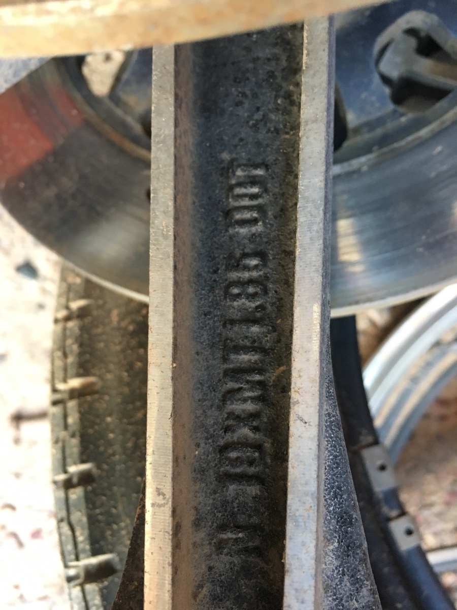

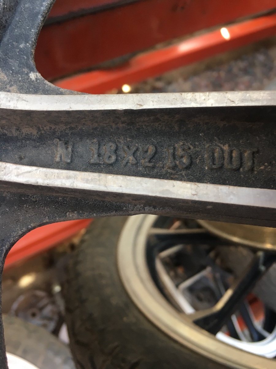

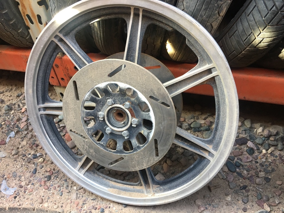

So I stumbled on these wheels while searching the local motorcycle graveyard. They are 19” front/18” rear, with 15/17mm axle diameter, just like my 750, and have a 6-bolt rotor bolt pattern. I can’t for the life of me figure out what they’re from. Does anyone have any ideas? The rear is two-piece with the rubber damper, so I’m fairly certain they’re Kawas.

those are late 70'/ early 80's yamaha
