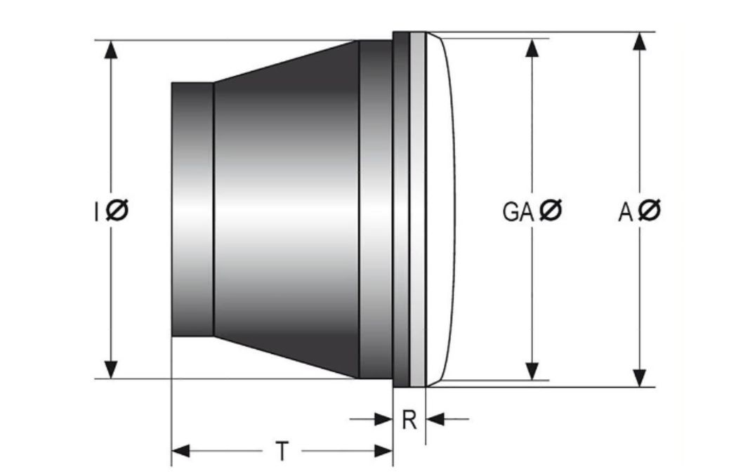

No eBay APP ID and/or Cert ID defined in Kunena configuration(Highsider Typ 3) price 149 Euro
www.louis.de/artikel/highsider-hauptsche...395b306c189f20092a0f
A = 177 mm
GA = 168 mm
I = 160 mm
T = 61 mm
R = 10 mm
You need Kawasaki KZ650 / KZ750 / Z1 / KZ900/ KZ1000 part# 23006-038/001
