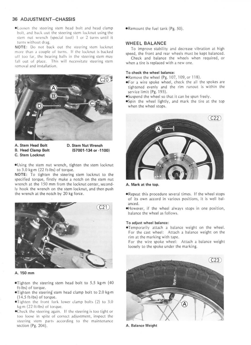

24 Feb 2018 12:43 - 24 Feb 2018 12:59
You have to loosen the fork legs clamp screws from the upper triple before you tighten the steering stem bearings.
Otherwise you will put stress/tension to the upper neck bearing.
As Nessism said.
service manual
Michael
As Nessism said.
Then tighten the big stem head bolt screw,(this will give an extra tension on the stem bearings),check swing to both sides goes easily again. If it drags, loosen the stem lock nut 1/8 turn back and try it again.Slowly tighten down the adjuster nut until all the play is gone and then stop. With the front end off the ground the handlebars should flop to the side relatively easily.

Ok cool thanks for this.
2 more questions I guess....
1. Is there a way to achieve the proper torque without that weird pusher type tool in the photo? It seems as if every little task requires the purchase of a new special tool ugh.
2. It says tighten it to “20kg” force. Isn’t that like 144 foot lbs? Seems really high to me. Not sure if it was a typo.
Thanks in advance!

144 foot pounds is WAY TOO HIGH! What manual says that? Notice in the image Scirocco posted above it shows the steering stem locknut should be tightened to 22 foot pounds. Ed

It says 20kg, but at 150mm, not a foot or a meter. I think that works out to about 21lb-ft.
