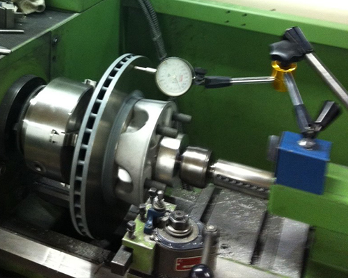

04 Feb 2018 14:28yikes. i did just have a machine shop remove some a few 16th from the sprocket side on my carrier. what the hell do i do now?
Bring your sprocket hub to an professional machine shop.
The sprocket hub has to be trued with a dial indicator on the lathe
for a wobble free turn around (axial/radial on the bearing side) before machining.

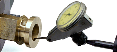

i went out tonight and picked up a dial indicator. with everything mounted in the swing arm
my wheel has .002 of deflection
and my sprocket has .008-.009 wobble
and when i put it on a surface of the carrier that was machined im close to .010 of and inch deflection. This is what i have to be seeing in my chain.
