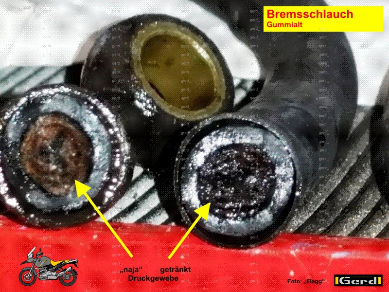

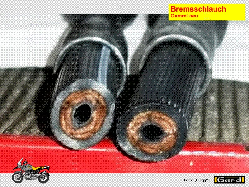

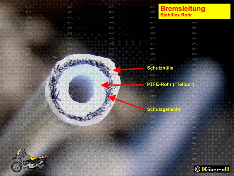

To much travel in the brake leveler is a sign of air in the break line(s) or caliper(s)
1/2 mc piston = single disc, 5/8 mc piston = dual disc
If you use rubber break lines go and buy modern steel flex lines and do a correct bleeding.
rubber brake line new
rubber brake line old
steel flex brake line
