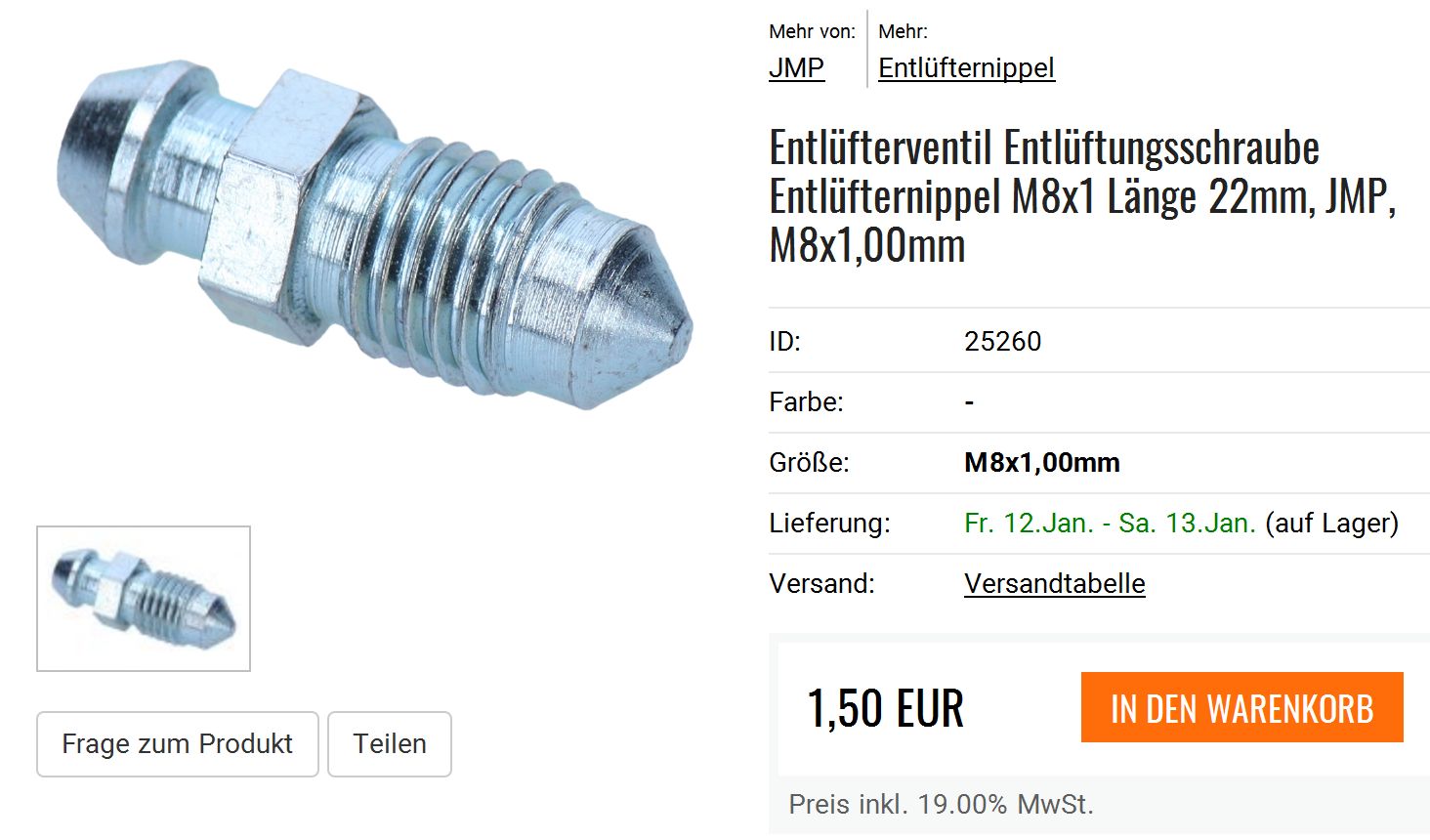

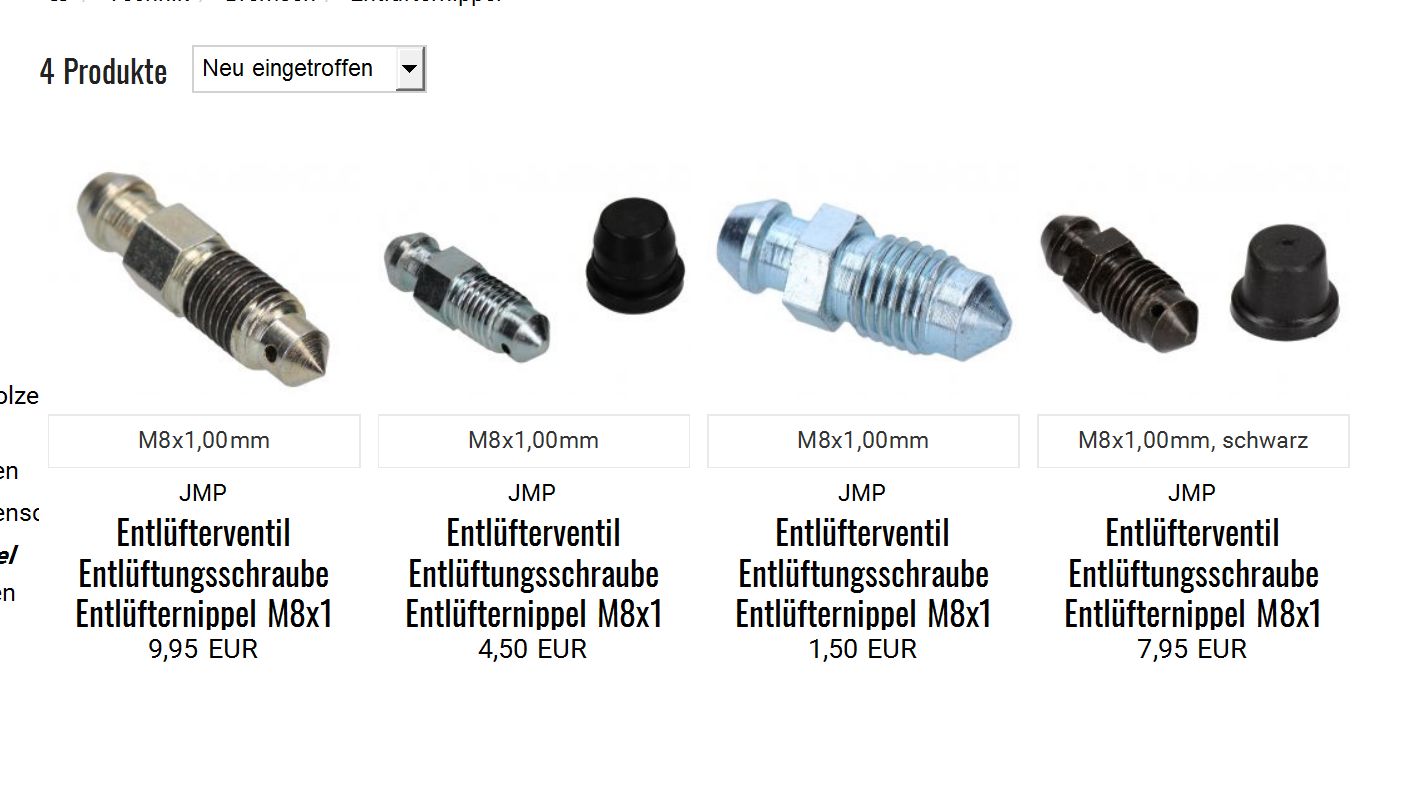

- Thanks: 2260
Re: Brake Calipper Bleed Screw
10 Jan 2018 22:42
- gordone
- Posts: 1533
- Thanks: 93
10 Jan 2018 22:48
Thank you, I have written these down in my project notes
It need to come some later in my project, but good to have a plan
What I have not have decided is if I should make bigger thread on the brake caliper on the other site of the wheel...
so the bleed screw size is the same... for the look.... what do you think?
Project:
Project:
- Thanks: 2260
10 Jan 2018 23:04

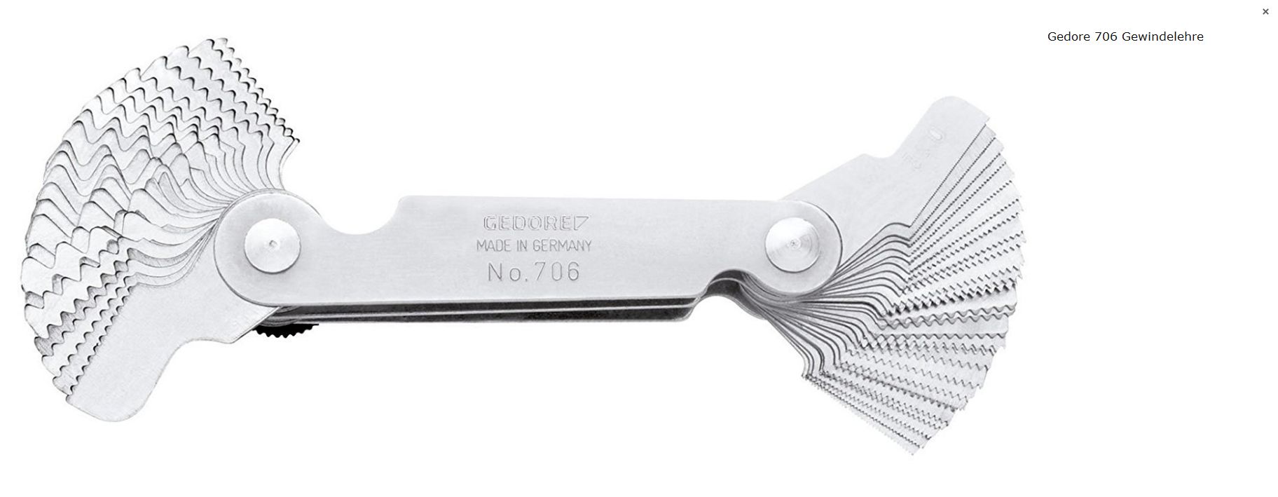

I think you need some of this bleeder screws (Metric 8 mm / 1,00 or 1,25 mm pitch)
They are available in (M6x1, M7x1, M8x1.25, M8x1, M10x1, M12x1, ...) Europe and (3/8", 1/4", 5/16" NPT 1/4", ...) for GB and USA
cars and motorcycles like NORTON, Harley-Davidson and so on....
Check the threat pitch first with a gauge
Michael
