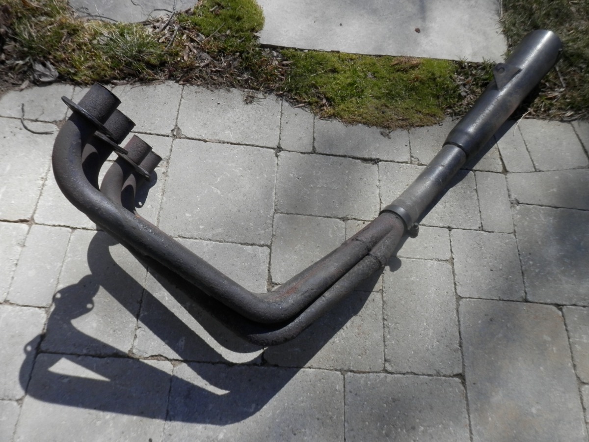

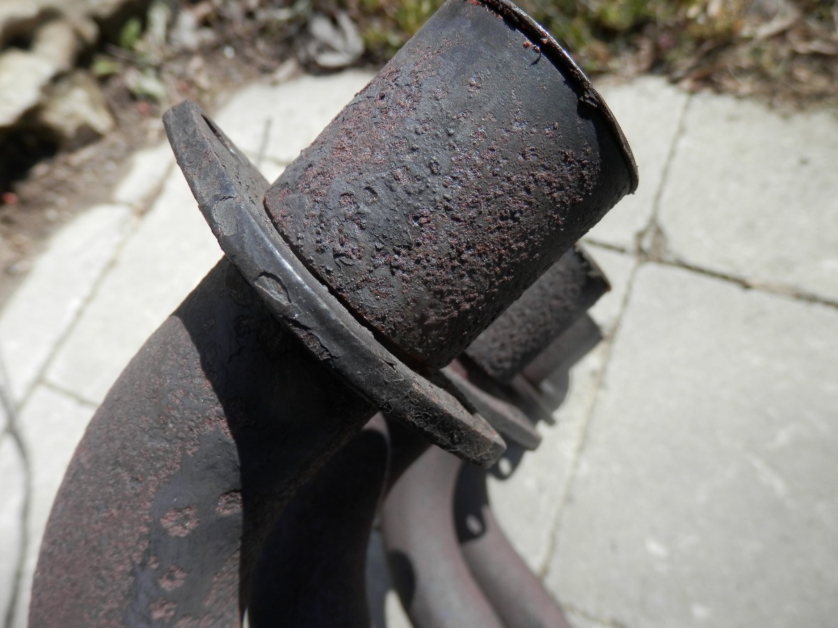

For sure not on the MAC 4 ->1 that I took off my 750 last March. As you can see from the photo the flanges would have been installed when the exhaust was assembled and were soft and easily bent when tightening down - low torque with short wrench or socket handle - causing exhaust leaks.
Perhaps the MAC you have if indeed a MAC might be a different design. It might be advantageous to post photos of what you have and see how other members respond.
