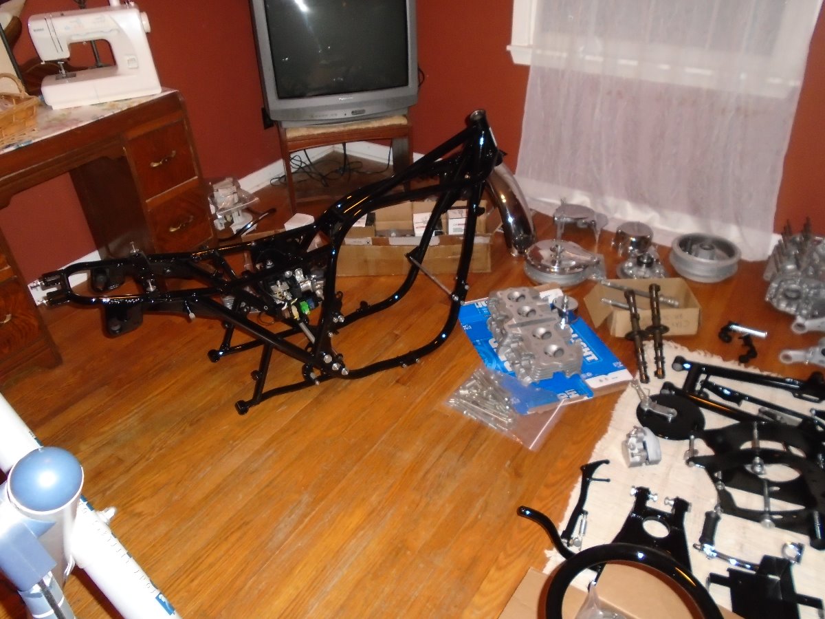

I'm doing a restore on a late 73. Came with One of each style fork lowers, One early nub and One later blended. Any one ever seen production bikes that were sold off the showroom come this way?
