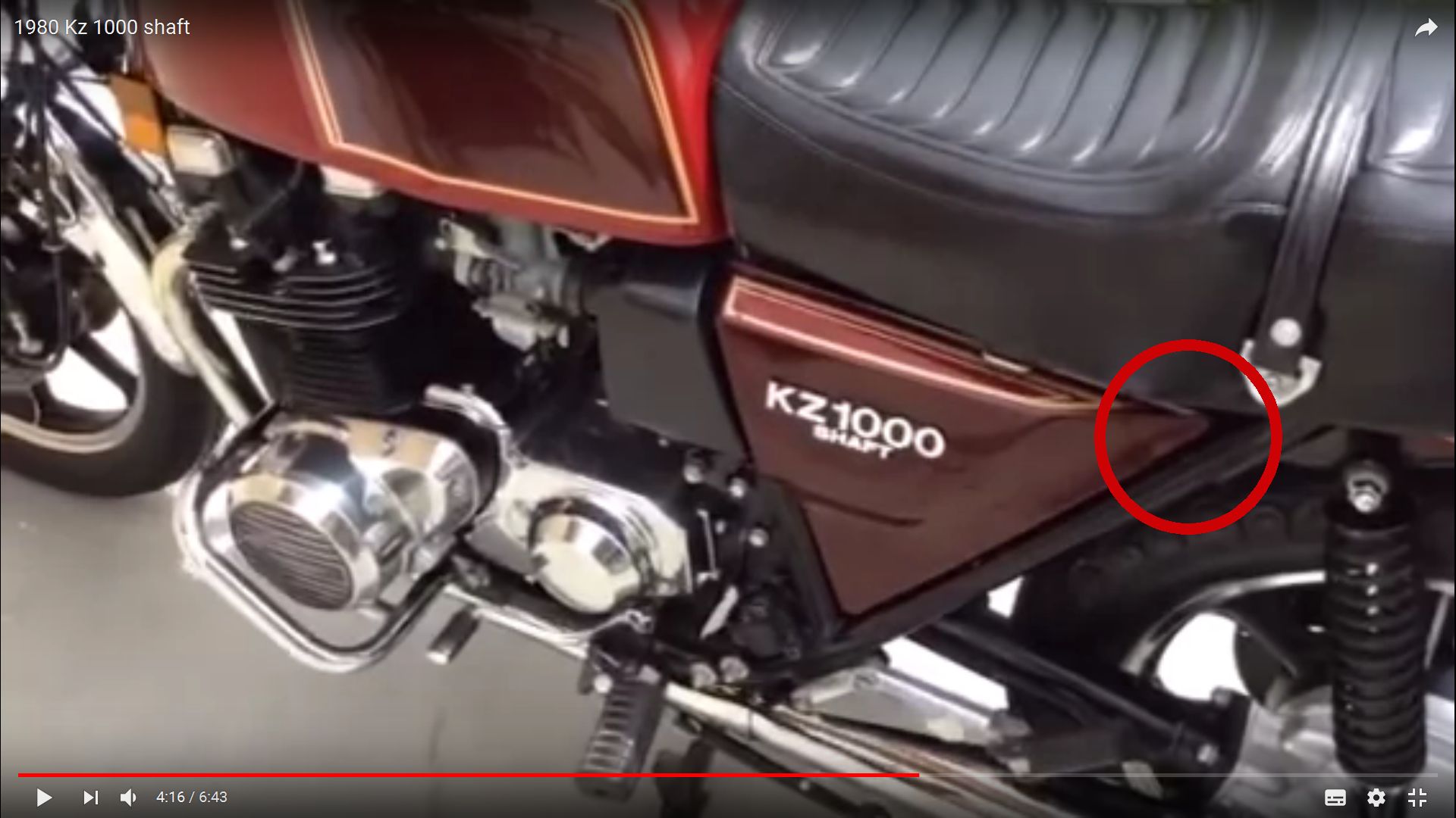

What is this this for?

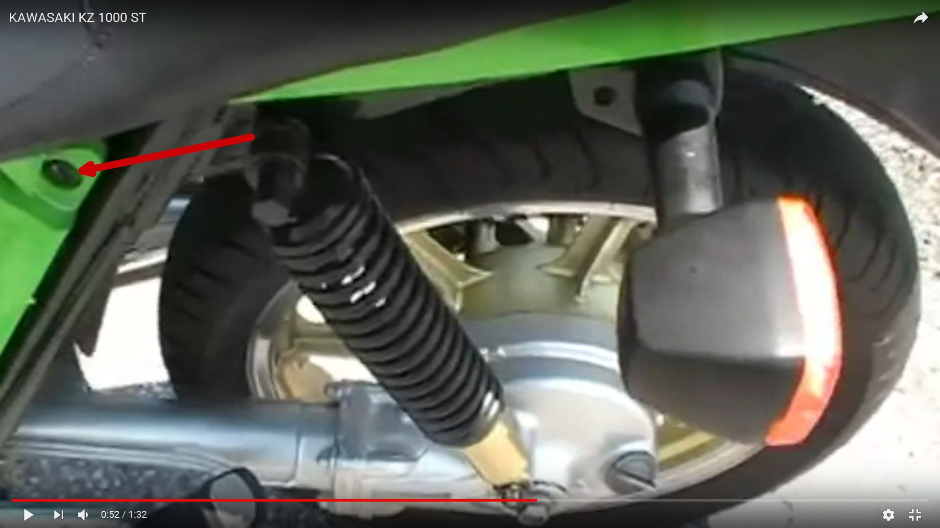

Thanks, but the item in question is well below the seat lock. My seat lock is intact and functional. This piece looks to secure something to the frame rail. It sits rather low on the tube, below the fuse block. just above the level of where the snorkel would be.

No eBay APP ID and/or Cert ID defined in Kunena configurationHi Larry, that would hold the small version of the auxillary kick start shaft lever like the Z1R's use under the seat.

Wow, how interesting! Thanks for the info! my bike came with the kick start lever on the side of the motor. I thought it was a bit dangerous with that thing sticking out. I hadn't thought that it was a removable, start lever for emergency situations. Clever. I can't picture pushing the ST to bump start it!

No eBay APP ID and/or Cert ID defined in Kunena configurationYes Larry, and then they have this cover. OEM Stock would have had this:

No worries Marty, I appreciate your help already. My next question is how is the lever stowed? I have the lever and the bracket but can't figure out how it's all packed in there? Is there a diagram somewhere of this arrangement? Or better yet, a picture!
