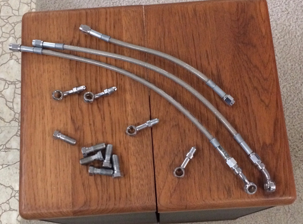

OK Gord 1. You are in Norway! Shipping must be real tough!
So, I am sure you have your Harley Davidson people and shops!
Just go to a harley shop and buy some parts. All the new HD stuff is 10mm.
Stainless Braided hose is sold by inch increment pieces, 10" - 11" - 15" - 20" and whatever etc.
The fittings are also every angle and degree, 180' 90' 135' 45'.
All plug and play! I am sure a local HD, Chopper, Custom shop will deal with you! As long as you don't wear an opposing gang patch or colors! (LOL) This way you see items hands on. No International shipping.
OR! any Industrial, Commercial, Warehouse parts distributor that works on construction, heavy equipment. That make and repairs high pressure Hydraulic hoses for Industry. There is plenty where I live in USA.
They can set you up. I made this stuff up 5 years ago, Dual discs for a 76 KZ900 all done at about $80.00 US dollars
