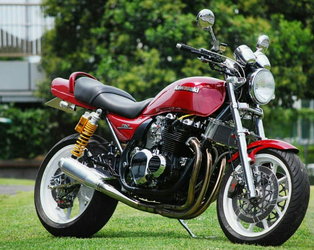

Sorry I don't know if they can swap, but search some photos of bikes with the wheel swaps. The small wheels on the old bikes sometimes look funny. Make sure you are ok with that. This one is not too bad, but you get the idea... all that space between the wheel and the handlebars makes it look a little scooter-ish.

CB550 (1978)
CB500/4 (1972)*
KZ1000CSR (1981)
XT 600E (1999)
TDM900 (2003)
CB550 (1978)
CB500/4 (1972)*
KZ1000CSR (1981)
XT 600E (1999)
TDM900 (2003)
- loudhvx
- Posts: 10863
- Thanks: 1622
Re: 87 ex500a ninja wheels on a 82 kz750e
27 Nov 2017 11:08
Yeah, like that. I'd still ride it, though, maybe not in public.

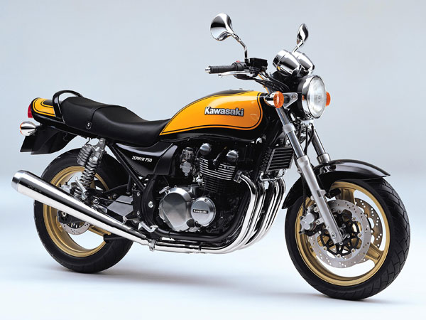

Most people use 17" wheels for better tire selection. That bike looks nice from that angle. I think that zephyr came with 17" wheels originally. Maybe it's a 2006.
www.motorcyclesdetails.info/Kawasaki_Zephyr_750_2006.html

I would like to suggest that you swap the entire front end fron a Zephyr. Fork, wheel, brakes the lot.
the Zephyr front fork fits if you change the stearing neck ball bearings to the Zephyrs roller bearings.
Beacuse fitting just the wheel will require quite a bit of fabrication to get the Z750E brake calipers to fit the Zephyr brake rotors and making spacers to fit the wheel in the old fork.
