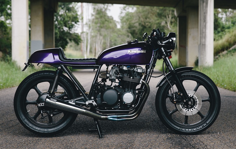

The smaller hub components makes sense. The bike I saw ↓ with an 18" drum rear looked like it had a really small drum.
Digging around some, it looks like both the KZ440 and KZ650 use a 17mm rear axle. If I have to machine up a couple spacers to center the wheel and/or chain, that's not an issue.
Thanks for your help, Martin.
