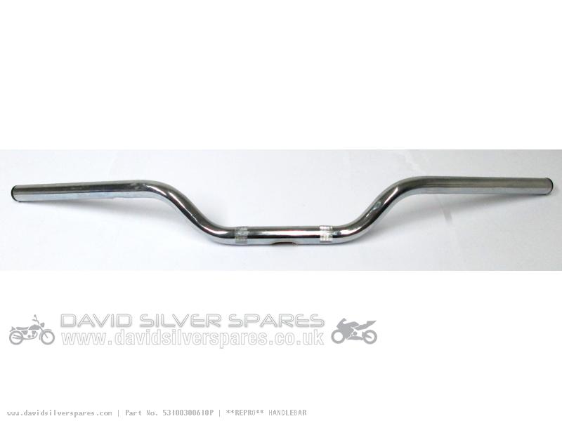

The Euro Bars that I'm running on my Honda are the one's that the European 71-72's had on the 750's. I purchased them from David Silver's and looks like the ends of the bars are angled up. Should work with this M/C ?

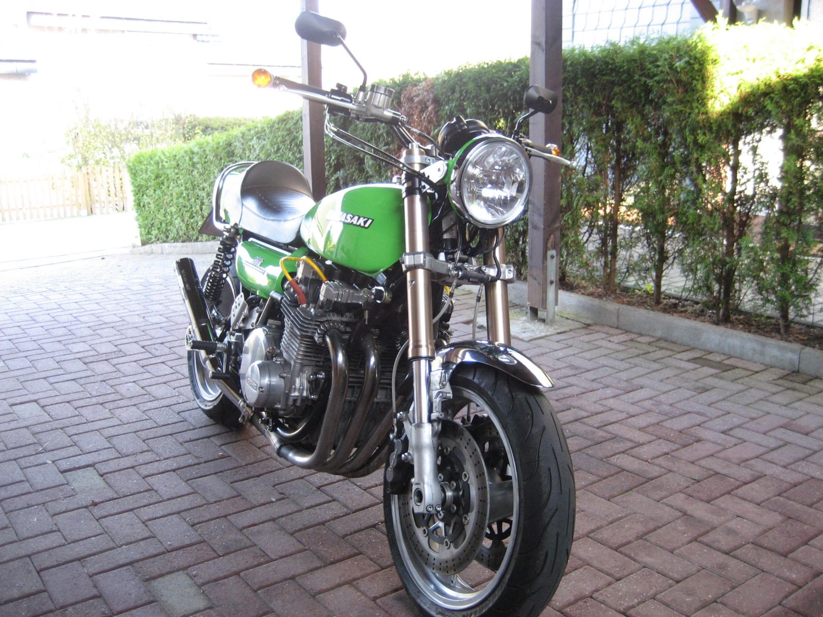

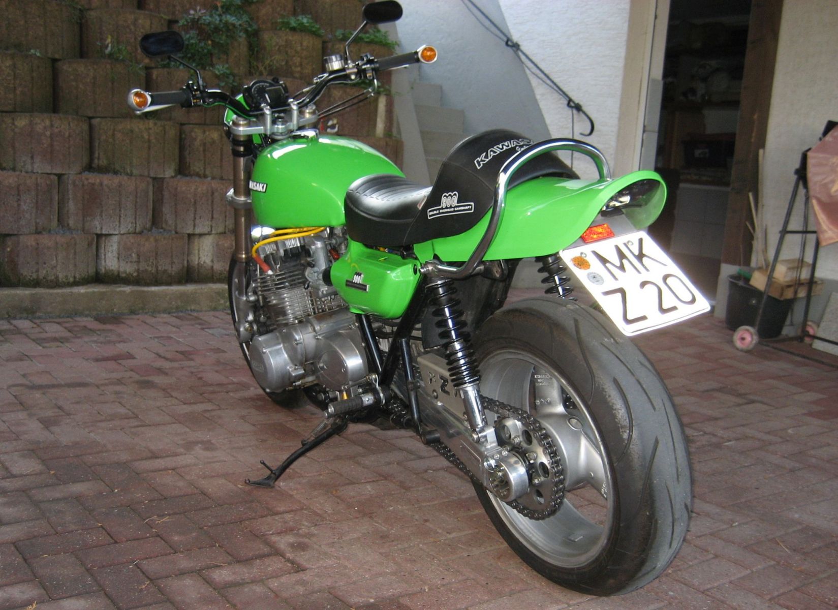

I use the same handlebar and like the lower style. No problem with my 14 mm MC (single disk) and i like the handling.

Motor got new seals, gaskets, cam chain and cam chain guide sprockets and guides, ported z1000J head with new valve seats for bigger valves (BMW), new valve guides and valve stem seals,adjustable cam sprockets, APE top chain sprocket adapter , APE clutch needle bearing push rod, oil pan swing door mod,......
Needs a big bore 1100 ccm kit or more and some RS 34 carbs ,(on the to do list for the next year).

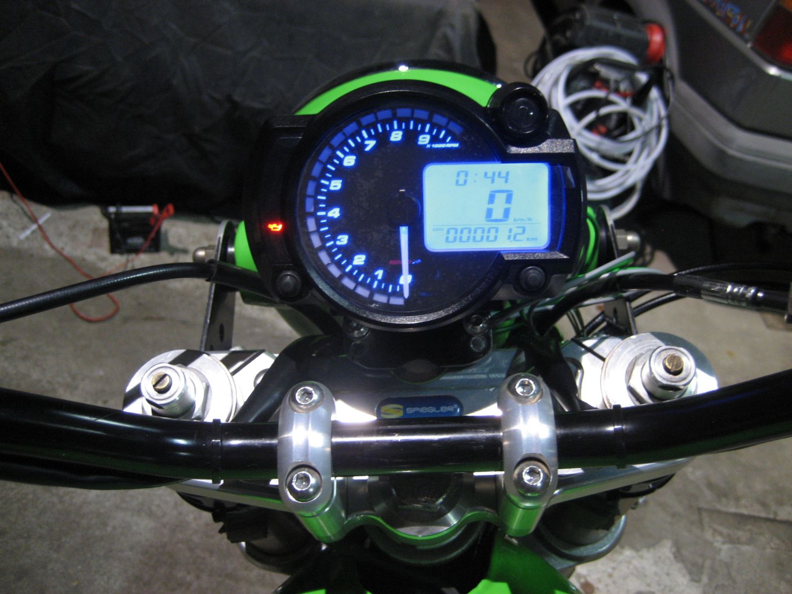

I don't know what front end and swing arm that your using but what are the gauges your using ?
I'm changing my front 19" wheel to an 18" and with recommendations from the Forum, have purchased a 24-T speedo gear. Don't know if it will fit stock speedo gear assembly and how difficult it is to change out but will see ?
If not, what speedo and tach assembly are you using ? Does it correct for speedometer error ?

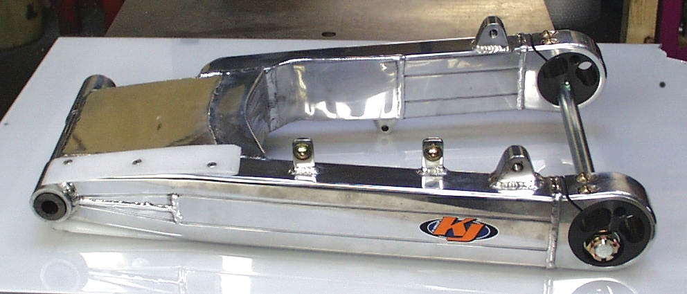

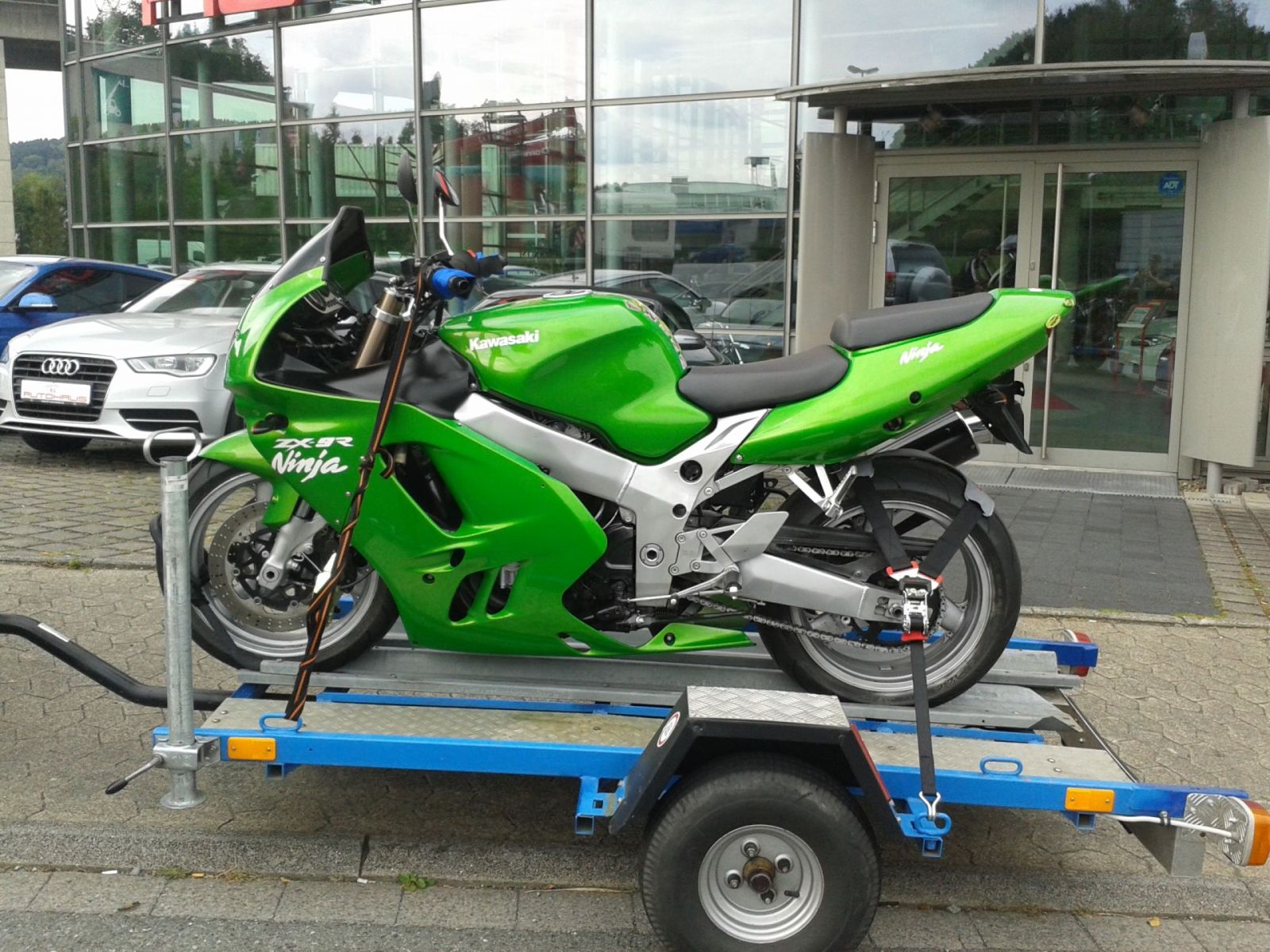

Front end, wheels and brakes parts are from a ZX-9R Model B (94-96).
I bought a cheap donor bike for my Z1B project.
Swing arm is made in Germany by Krüger & Junginger
www.krueger-junginger.de/html/alu-schwingen_k_j_profil.html
Speedo and tach is a KOSO RX2N+ GP Style with lot of functions like speed and rev limit flasher,oil and engine temp sensors.
It has a inductive speed sensor that count the speed signal from the rear or front break disk screws.
Number of screws (Signals per one wheel rev have to set into speedo) and the tire scope input ( for me 1979 mm )
for the correct speed displayed. Easy to install and it comes with all parts you need.
