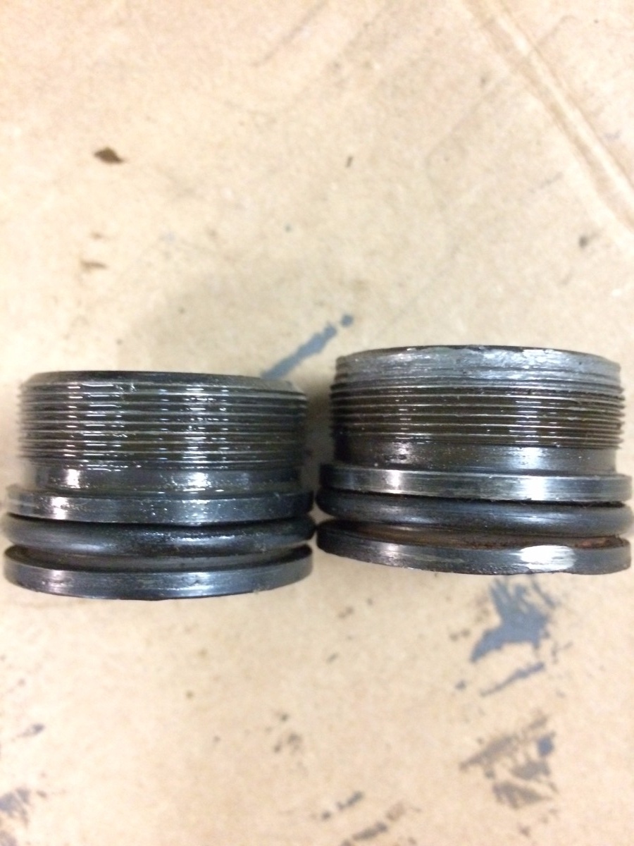

The PO of my KZ1000ST has been leaving surprises on the bike for me to fix as I start restoring this to running shape. The right fork cap came off easily as usual. However, the left one didn't budge when I went to remove it. It took my impact driver to finally spin it out.
I'm going to remove the bottom three rows of threads and file in threads to see if it starts.
This is a PITA..
This is a PITA..

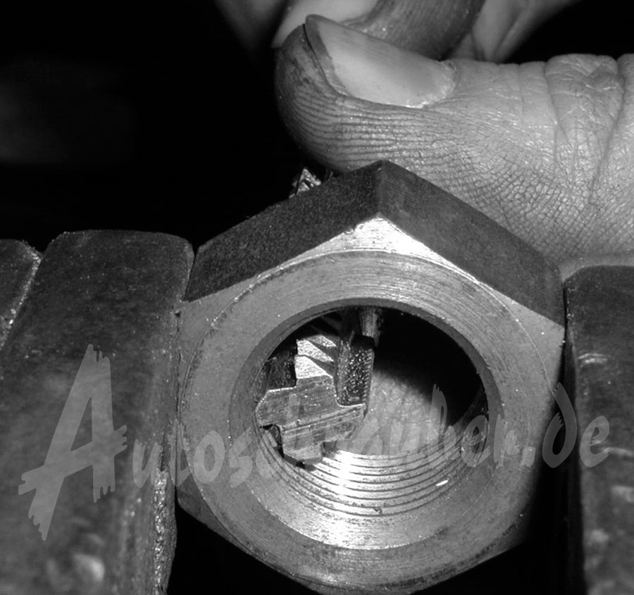

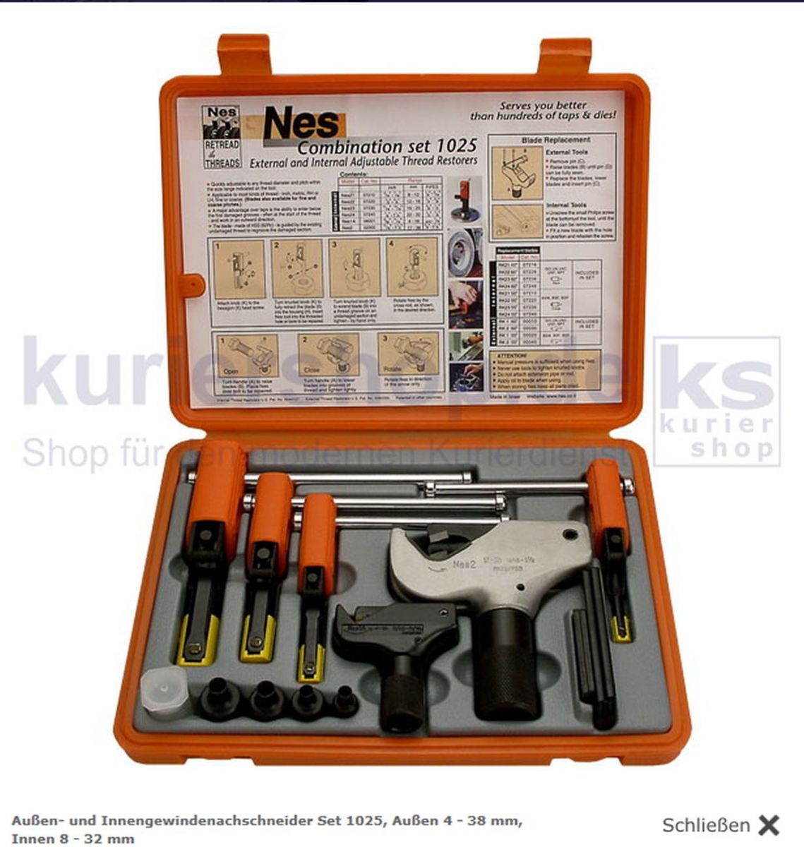

There is threat re-cutting tool up to 16 – 38 mm / 5⁄8″ – 1.1⁄2″
No need to remove the damaged rows. A good machine shop should do it easily in less a minute.

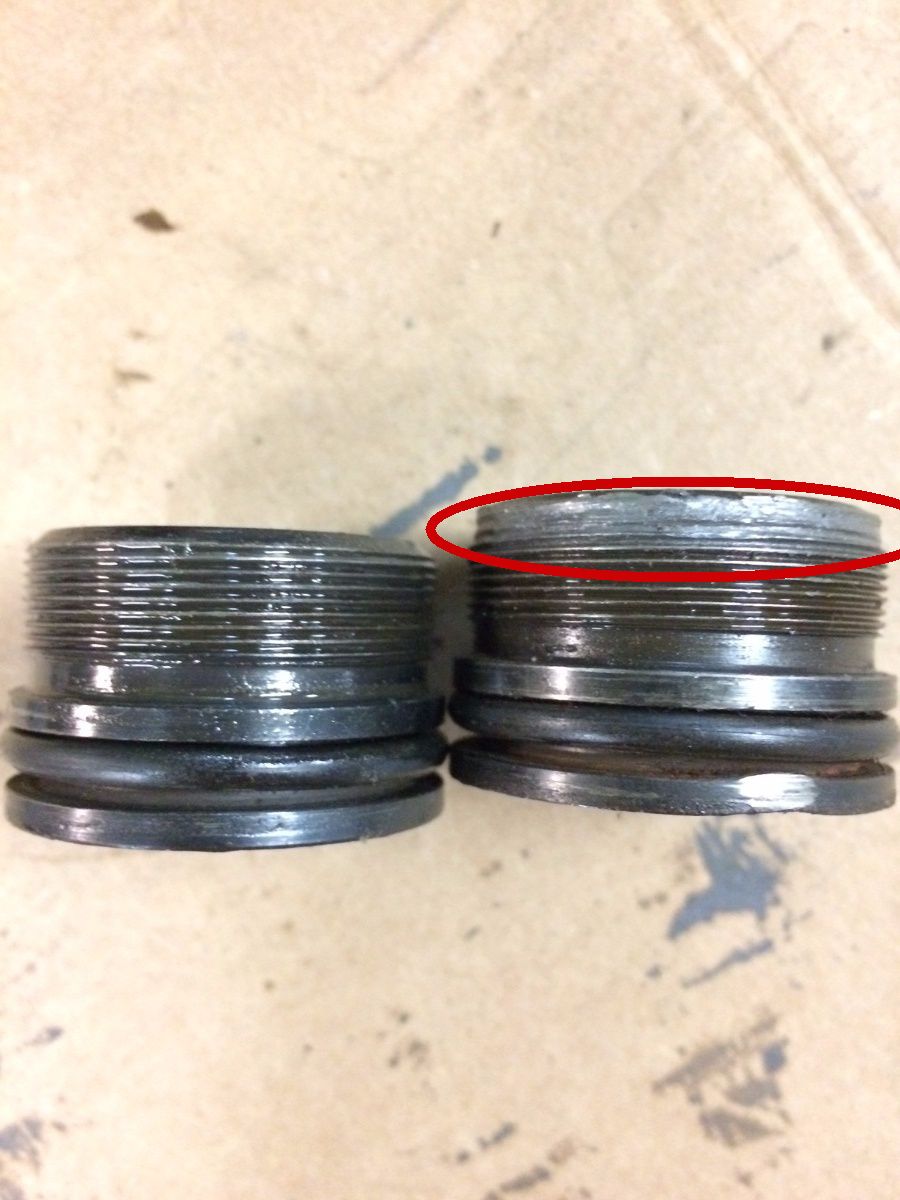

The cap has lost material in the bottom of the threaded area. I'm trying to dress it with a thread file now. The tube is stainless and seems to be in good shape. That said, the material that was lost from the cap has become imbedded in the tubes thread and it's tough to get out without damaging the existing threads.

if you lost some rows of the threat the remaining threat will do the job as before the damage..
Nothing to worry about it.

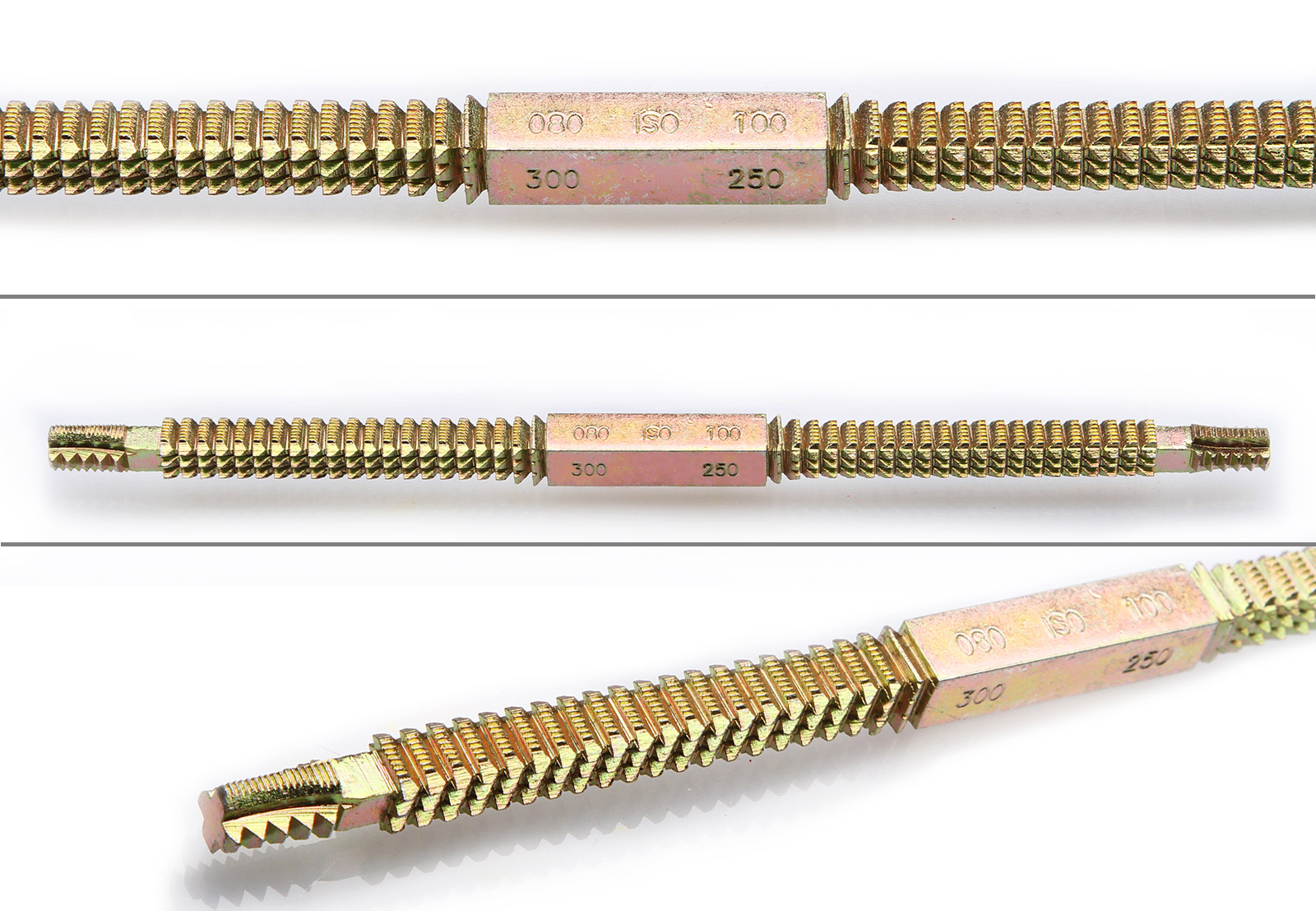

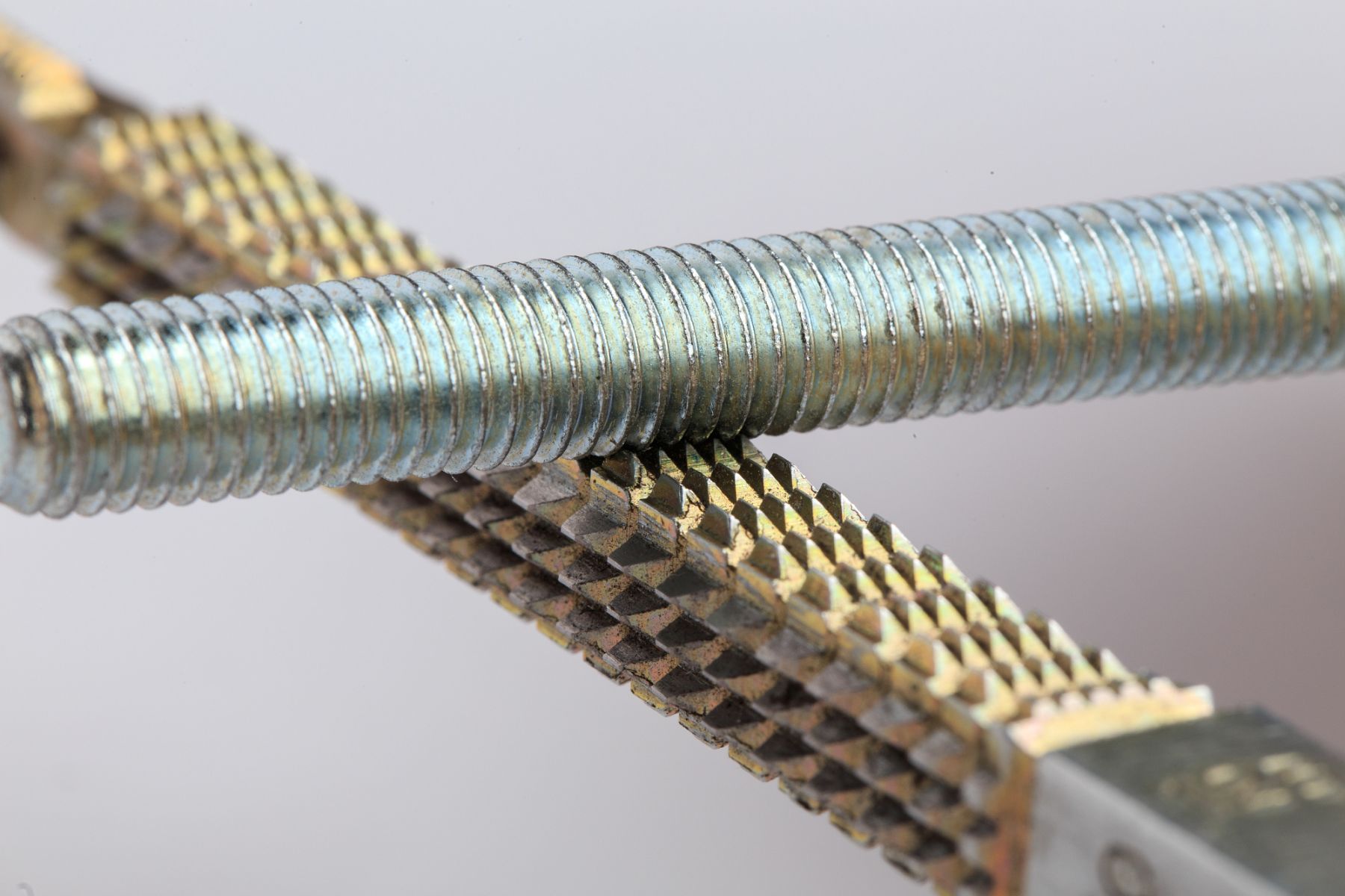

That's exactly the kind of file I'm using on the cap. The tube is where I'm having a tougher time. My goal is to be able to dry fit it before I assemble the forks. The material that's left in the tube is stuck in the threads and keeping the cap from spinning in.
Is there a file or something that will help clean out the threads?

Re: Cross threaded fork cap
03 Nov 2017 19:29
If you cannot pick out the old thread debris using a dental pick you may want to use a thread chaser (not tap) to clean the threads. Ed
