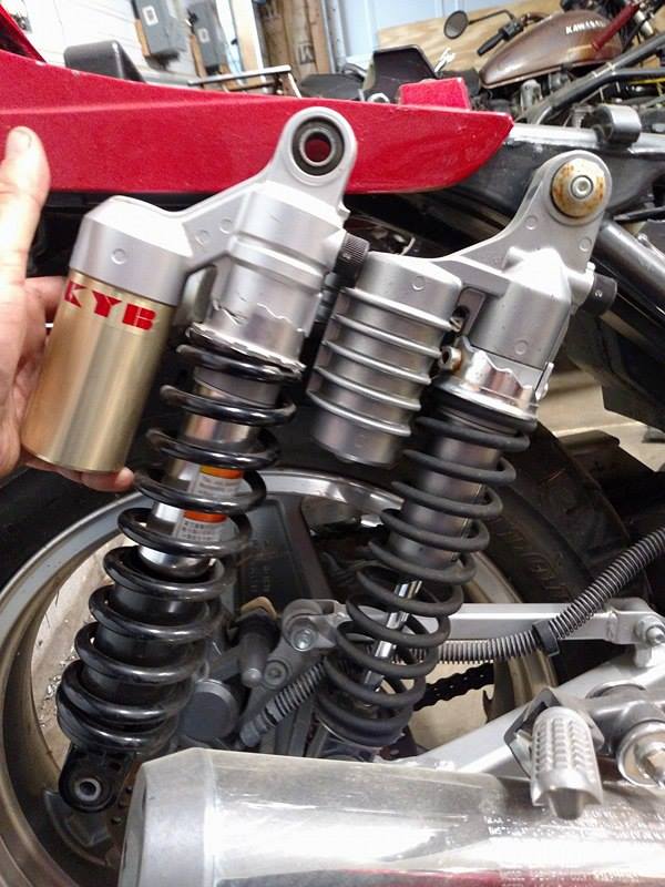

I really can't say a 1100 shock is different having never had one in the shop but I can say the 750 is much different.
750 Zephyr on right, ZRX on left, ZRX definitely a better built shock.
Les Holt
Les Holt

Thanks Les for your photo and help, Yes im 100% with you. I used to have a ZRX1100 and agree the shocks are better than the Z1100R and Zephyr 750 shocks. I'm restoring my old Z1100R and trying to keep as many parts original looking as possible.
But ended up buying some second hand shocks, believing they were Z1100R. but they do seem to look more Zephyr 750 under the thin coat of home sprayed Gold! I have think even though the Z1100R and Zephyr 750 shocks boddies are the same, the springs may be different as the Zephyr 750 is a lighter bike than the Z1100R. I have e-mailed firefox who rebuild shocks to see if they can provide me with suitable springs. The ZRX shocks would make a good replacement if I cant upgrade the springs.
