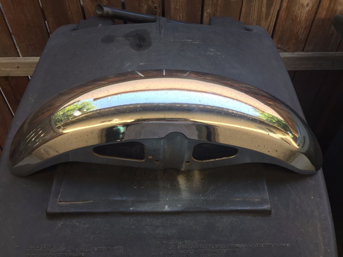

Is this fender only found on a KZ1000 MK2 ? Reason I ask, is that I', converting from a 19" front wheel on my 77' KZ1000A to an 18" and want a fender that was designed for an 18" . A vender is selling this fender but says it is for a KZ1000 A3 and A4 , MK2 and for a 19" wheel ? I thought this fender was on the MK2 only which I believe only has an 18" front ?

The KZ1000 MK2 came with a 19" front wheel. See link below. Ed

The Z1R is about the only KZ1000 with an 18" front wheel. The fender is painted & has fender stays. probably hard to find.
The police bikes have an 18" front wheel, but the fenders are big & fat, kinda like what you'd find on a big harley.
Various ZX models from the mid 80s had an 18" Fr wheel & some of the Fr fenders are similar in shape to the one in your pic. but who knows if any of them would bolt on.

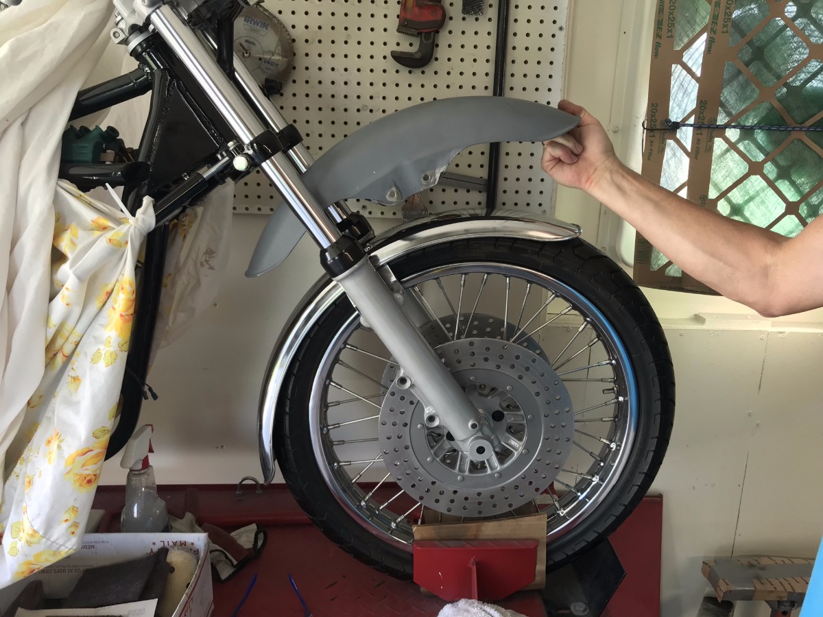

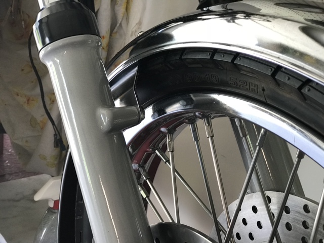

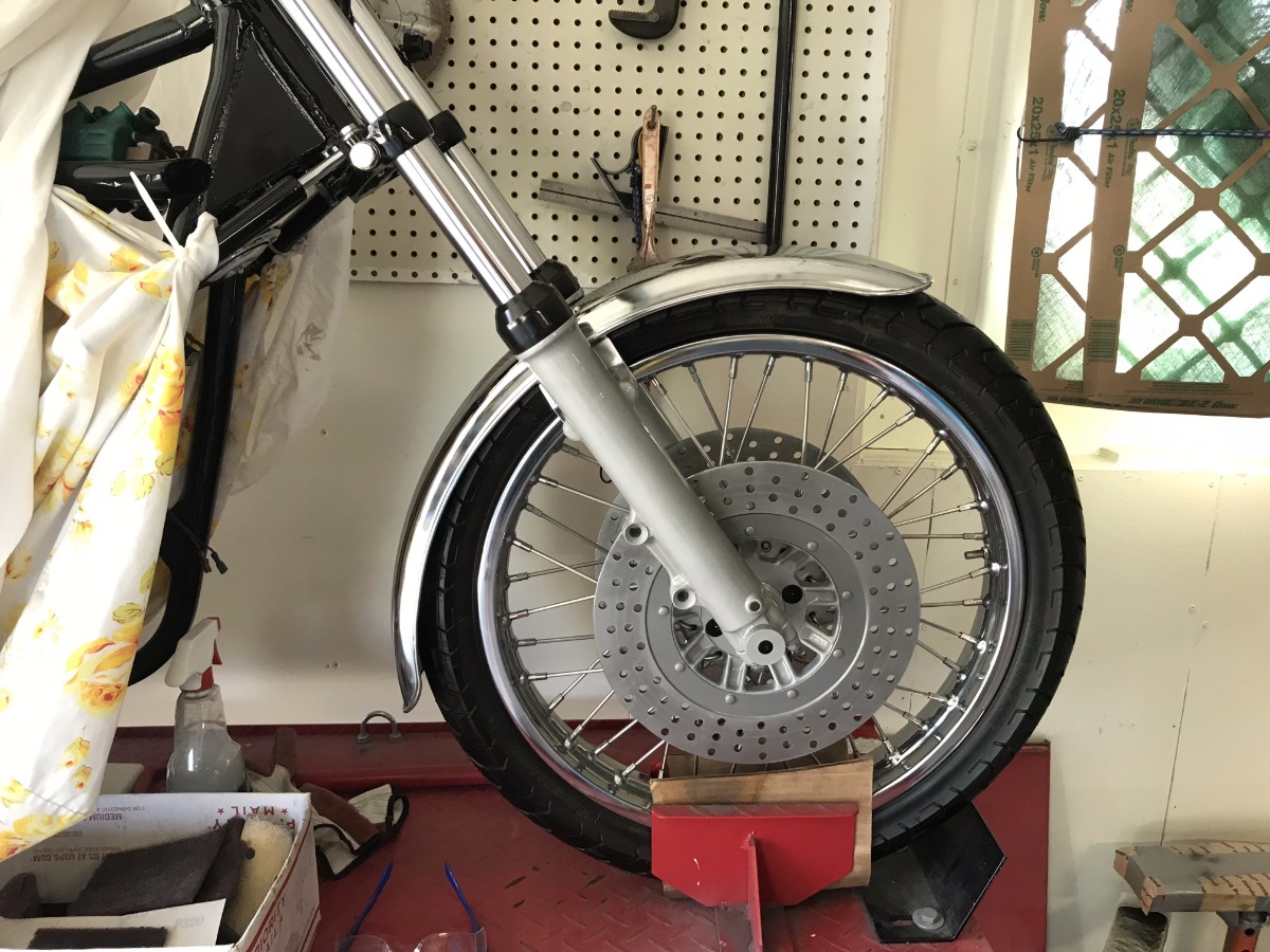

Here is the 78 KZ400 fender bolted on to the KZ900/1000 forks. This is a 19" wheel with a smaller 90/90 tire.
Fender bolts right on, same bolt hole pattern, 8mm bolts. I just cut off the cable holder and the 2 bottom tabs that held the bracket on.
I think a cut out of about 2-3 inches on the down, back side and re-weld it might look good. No one wanted those 2 chrome fenders on ebay in August?? It can be for sale if your interested?
