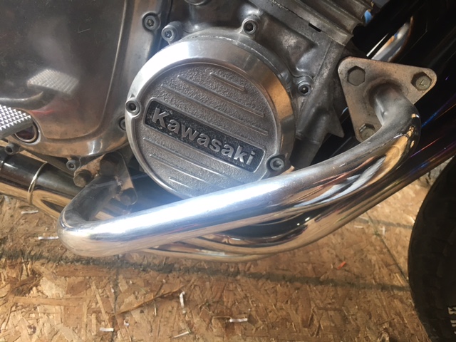

I have original Kawasaki 2 point case guards on both my KZ400s.

2 point with second cross bar.

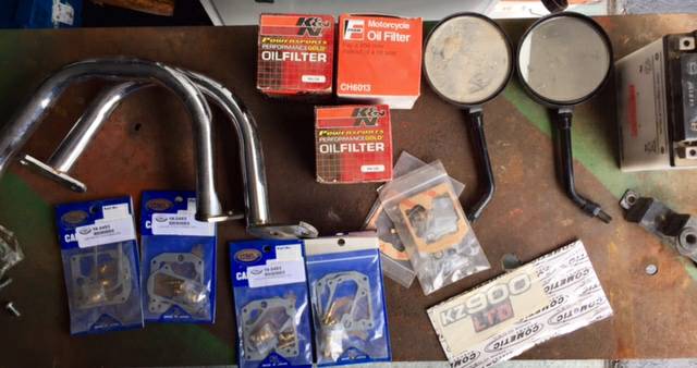

HERE'S A SET WITH A 12 YEAR SITTING BARN FIND WITH LOW COMPRESSION IN ALL CYLINDERS. nO ONE IS TAKING THE BIKE YET.
US buyers are low balling him. 76 KZ900 LTD Won't go below $2400.
But if you want a set in Western New York. They cost $2400 and they come with a original 76 LTD and a kerker header (LOL)
Look at Ebay/C raigslist

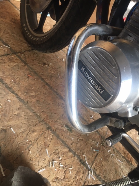

Others have reported that the 2-point case savers can fold over in a crash, even at low speed.

2 point only good for looks, if you like the looks of added bars. Do very little in the way of protection. I had the 2 point bars on one of my KZ650s years ago and had a low speed spill in a corner, the bar folded in and actually knocked off an oil gallery plug on the engine. I rode away and ran the engine out of oil.
