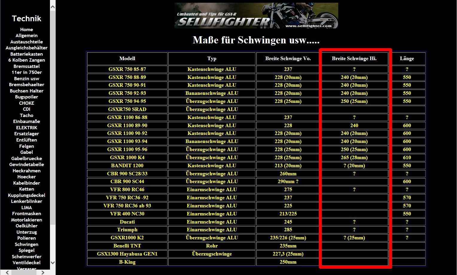

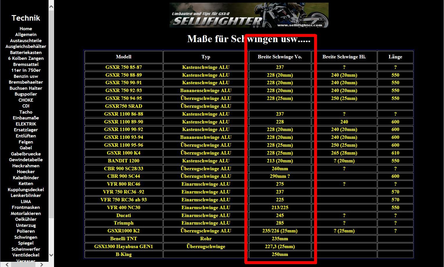

Ltd-18ner wrote
Your swing arm 241 mm = 9.5 inches
Z1, KZ900/1000 = 235 mm = 9,25 inches = 6 mm space left to 241 mm
KZ650/750 = 230 mm = 9,06 inches = 11 mm space left to 241 mm
Why shave off, you have to ad some washers to get the swing arms free of play!!!!
Plug and play and easy in and out. where is the problem ???
Here some swing arm charts
swing arms wheel opening (The values in brackets refer to the wheel axle AD)
swing arms pivot/frame widths (The values in brackets refer to the pivot AD)
So it looks like the width of my swim arm where it bolts into the frame is about 9.5 inches?
Hmmm...Looks like I'll have to shave off some of the area where the swingarm bolts to the frame
Last edit: 28 Aug 2017 12:38 by Scirocco. Reason: Ad some swing arm charts
