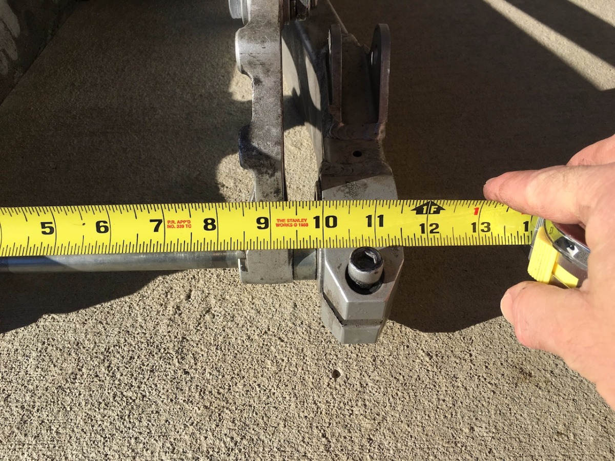

I can't offer advice on converting a unitrac swingarm to a twin shock, but I can give insight into the Zephyr 550 alloy arms.
The Zephyr 550 swingarms are 9" wide at the pivot point and 11.5" at the widest point at the rear shock mounts.
They are 20.5" long from the center of the axle to the center of the pivot bolt.
The stock Zephyr rim is 3.5" wide and when using this exact combination on my kz750, I had to use a 13mm offset front sprocket because the swingarm and wheel were so much wider than stock. It is an unknown if using such a wider arm on your gpz will lead to the chain fouling on the gpz frame.
To use your stock gpz wheel, you will need to source or fabricate custom wheel spacers, new wheel bearings and and probably reconfigure the entire rear brake system.
If you find a Zephyr 750 swing arm, beware that they are even wider at the pivot and axle area. They can accommodate a really wide rear tire, but they are way more work to fit in smaller bikes.
Make sure you also measure the width of your frame where the upper shock mount will be, so you know the minimum width the "new" swingarm needs to be.
Food for thought.
