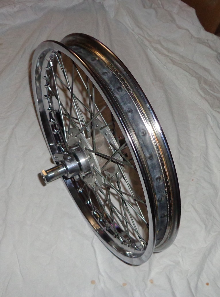

i'm about to sell an 18" spoke wheel. for drag bike slick or cool hot rod bike coolness!
It is a KZ900-KZ1000-KZ650 hub. It has the disc brake holes on both sides. I have a 76 KZ900 axle to go with it.
It is perfect for a vintage drag bike. Z1 900 / H2 750 / KZ 900 / KZ1000.
1.85 x 18 / 40 spoke takasago oem rim.
I am about to get some pictures later.

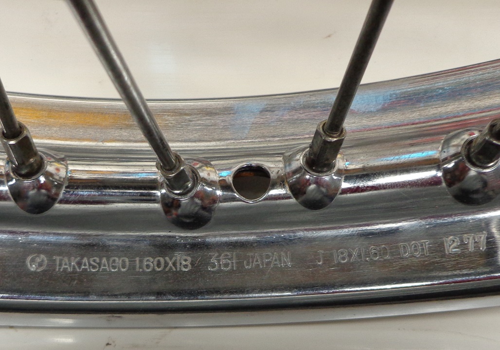

The wheel I have is a 1.60" x 18".
I did lower an LTD fender, old pic. I cut the bottom off and welded it
Cool drag bike look. Not good for highway driving with the small rim.
