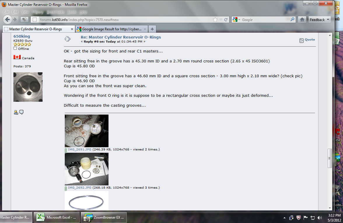

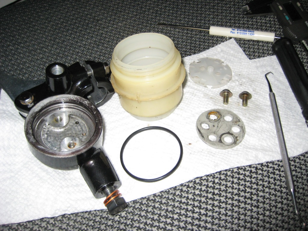

Apparently the round plastic reservoir is held on by 2 screws. Here's a picture of one taken apart. It is not mine, so I cannot give better details. Ed
The following user(s) said Thank You: ayeckley

05 Aug 2017 00:34650ed wrote: Here's a picture of one taken apart. It is not mine, so I cannot give better details.
Awesome! Is that from a KZR thread that I missed? Looks like the plastic insert needs to be removed from inside the cup somehow.

05 Aug 2017 06:11 - 05 Aug 2017 06:12ayeckley wrote:650ed wrote: Here's a picture of one taken apart. It is not mine, so I cannot give better details.
Yes, I believe the insert must be removed to gain access to the screws. That picture was posted on KZ650INFO by a member whose ID is 650king. I don't know if he is still a member, but if you go to that site and do a search you may be able to find more info. I saved that picture and the one below for reference about 3 years ago. Ed
Last edit: 05 Aug 2017 06:12 by 650ed.
