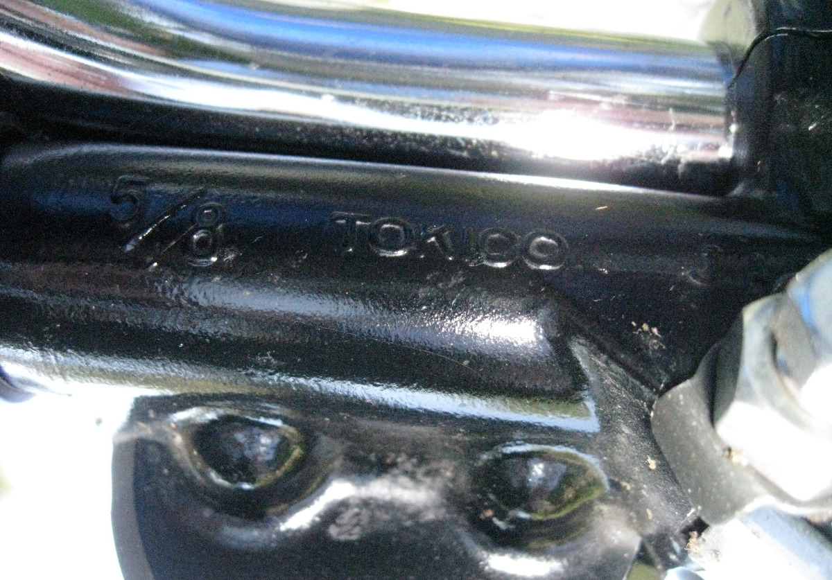

The stock dual brake master cylinder that came on my KZ650-C1 is 5/8" and is marked as such on the bottom (see image below). 5/8" = 15.875mm. Ed
