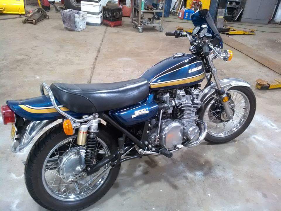

I run them on my Z1B. I spaced out the left shock with washers to clear the chain. Also had to rebuild them due to failing bladders. Good damping, easier on my back.

Nice, Kidkawie, they sure look sharp on your bike! Fit right in with that paint scheme!

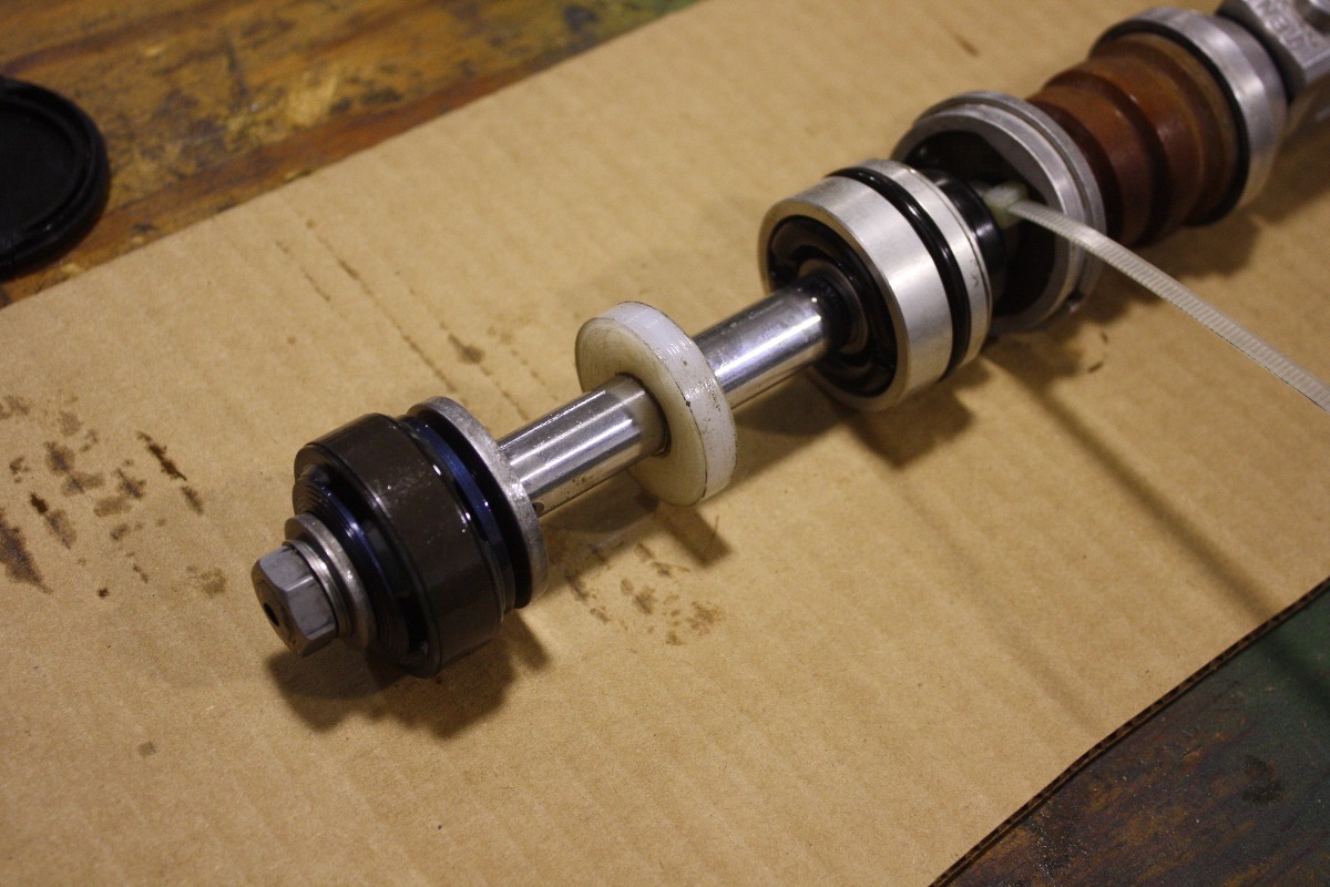

I rebuilt them myself. I used heavy duty zip ties to compress the spring, couldnt find the exact length bladder but have the part number for one thats close, used 2.5wt shock oil. Cost about $50 for both. I have to look but I think I have some documents on rebuilding/bleeding them. They are 1/2" or so longer but it doesnt seem to make any difference when theres weight compressing them.
I also did tgat mod where you cut off the spring preload adjuster tabs which lets you use the upper housing as new tabs. The inner sleve gets loose so I took it a step more and welded the inner sleve to the preload adjuster.

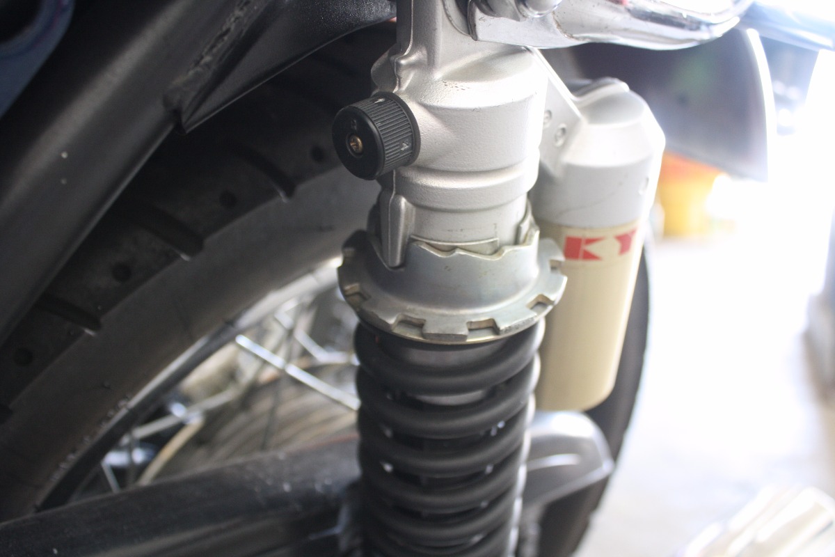

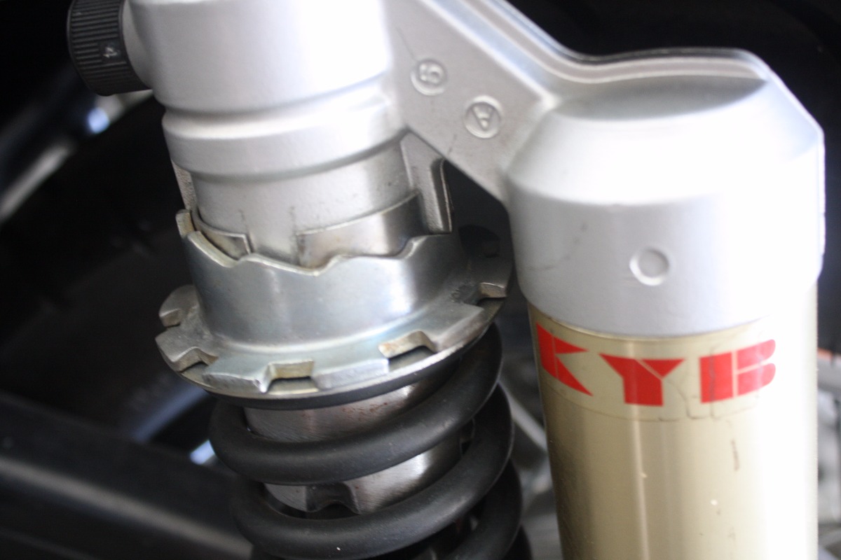

Ill try to get some pics tomorrow, but you basically remove the preload adjuster nubs then use the upper housing instead. Besides that, you can put limiters inside the shock.

See pics. With the nubs removed from the inner sleeve, the sleeve can fall inside the shock because nothing is holding it up anymore. I indexed the inner sleeve with the preload adjuster ring and welded them together. You cannot remove the inner sleeve alone because then there will be too much slop between the shock body and the preload adjuster. Static weight on the shocks they measure 13.25" eye-to-eye. Tha bladder I used is 46mm x 88mm, part #120104600101, original bladder is65mm long, Race Tech sells original size for $100/ea but it's not that crucial IMO.
