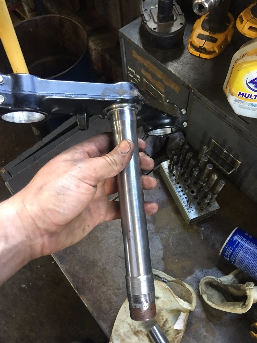

As opposed to what i read about the other steering stems, the zx600 stem is the same diameter at the lower triple as the stock kz stem, AND it is not tapered. This means that the stock kz stem can be pressed into the zx600 lower (from the top i might add). Just pressing the stem in alone probably would have been enough to ensure the stem stays put but as an added level of security i welded a 1/2" nut into the bottom of the steering stem so that i could put a bolt with some locktite through the bottom to ensure the lower triple isnt going anywhere. heres a poicture to show what i mean:
Steering stem length is close enough to the original length that you dont need to do any shaving on the lower triple. If you look at the lower triple in the bottom picture youll see a shoulder that will end up butting up against the lower steering bearing. At first i was concerned that this would cause issues with mounting the upper triple but in the end, there was still enough threads at the top for the adjustment fasteners.

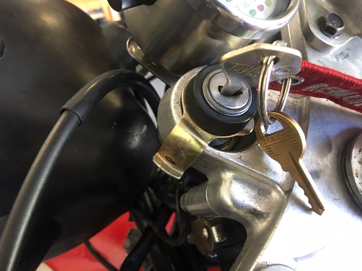

The only issue i have left to sort out is the mounting of my ignition switch. this was my temporary solution:
if anyone has any better ideas for mounting this switch thatd be great. I may just fab up a quick plate that goes on top of the triple and serves as a retainer for the switch but i think that may look too out of place.

Thanks for the report. Does the ZX600 ignition switch normally fit into that hole? If so, you could get a zx ign switch. Also, there are ignition switches that have a long neck, so you might be able to mount one of those from the underside. You'd have to come up with a mounting plate & maybe a round damper for a clean look. I'm assuming the ZX600 upper triple has bolt holes on the underside for a meter bracket.
just an example. there are others.
