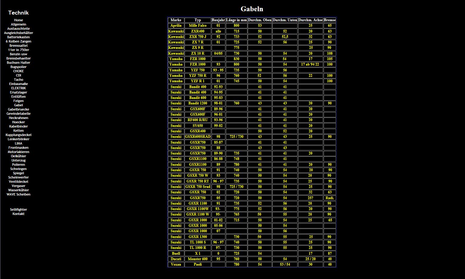

If you want to go with a newer fork you need to know the the length of your fork legs.
Here is a fork chart with length / axle OD / caliper mounting point distance / fork leg OD for upper and lower triple
Maybe you have to go with new front calipers matching to the fork your go for.
Most Zed bikes using ZX-9R forks, they are the longest,( like i used on my project bike )
A how to for the stem swap
Like TexasKZ said, there is no easy bolt on and you have to do some mods but nothing impossible, only a "little" metal work.
