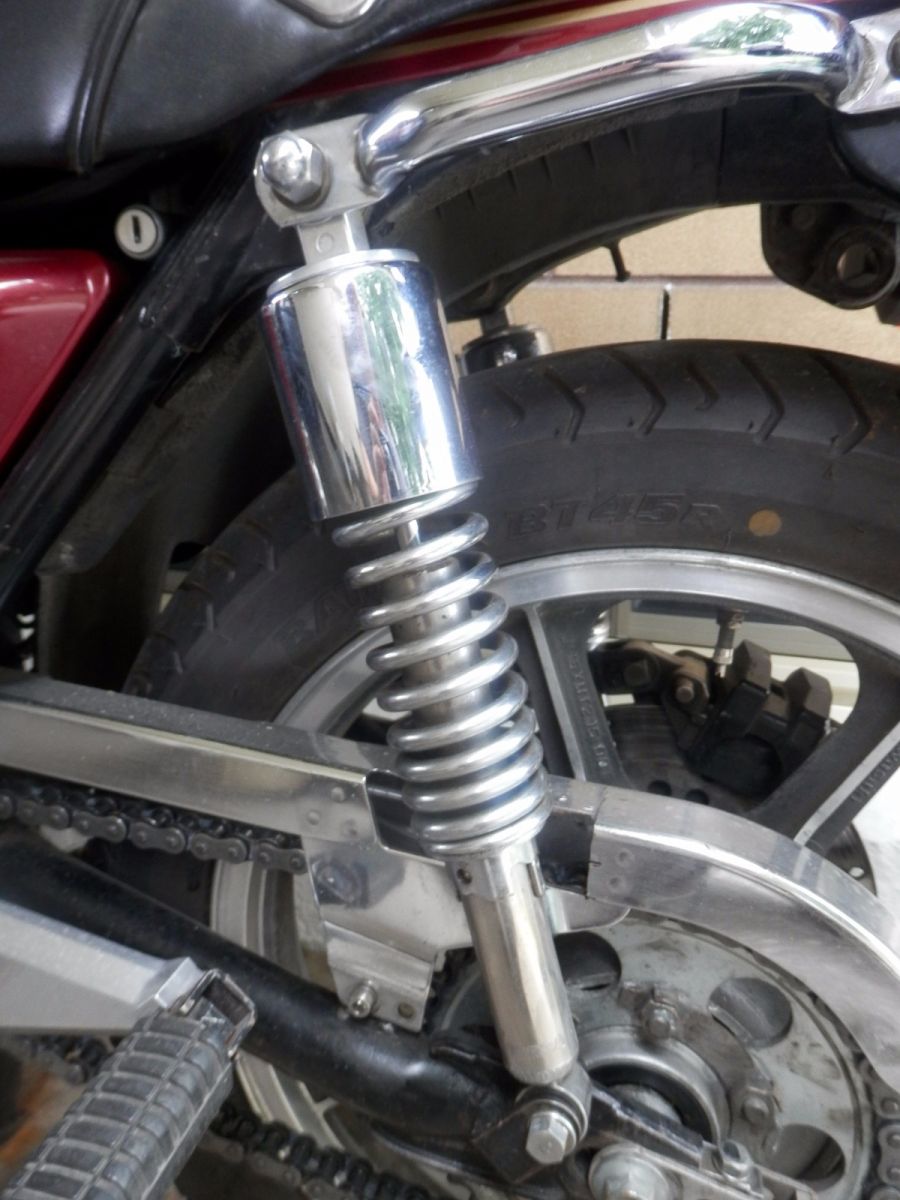

They look like shocks I bought a few years ago from Z1Enterprises. Z1 still sell the same shocks but with a red reflector. Mine have "FORSA" stamped on the lower end. Forsa are a Taiwan based shock manufacturer.
I find them ok. Certainly better than the original shocks which they replaced and just fine for what I do.
I measured and mine are 350 - 355 mm or thereabouts. A bit longer than stock. If you go with a longer shock check drive chain tension with wheels on the ground rather than bike on centre stand
Here's a photo for comparison.
