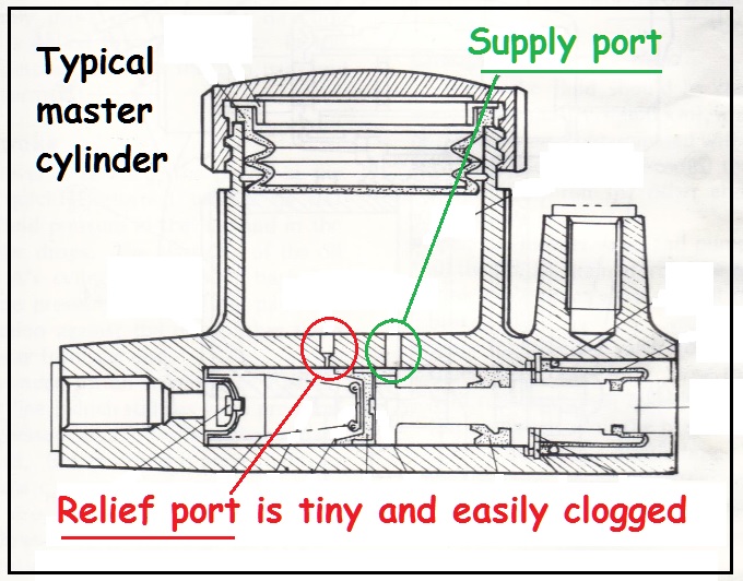

I strongly advise a full system tear down and gunk clean out. That means popping out the caliper pistons and taking apart the master cylinder. Inspect the master bore for pitting and replace as necessary, then reassemble with new a OEM Kawasaki brake master plunger and seal. For the caliper, inspect the piston and replace if it's pitted, and then install new OEM kawasaki seals. Also, replace the brake line since it's full of gunk.
BTW, the reason the system is applying pressure is mostly likely because the return port in the master is plugged with gunk.

21 Jun 2017 14:15Nessism wrote: I strongly advise a full system tear down and gunk clean out. That means popping out the caliper pistons and taking apart the master cylinder. Inspect the master bore for pitting and replace as necessary, then reassemble with new a OEM Kawasaki brake master plunger and seal. For the caliper, inspect the piston and replace if it's pitted, and then install new OEM kawasaki seals. Also, replace the brake line since it's full of gunk.
+1

22 Jun 2017 05:14Nessism wrote: BTW, the reason the system is applying pressure is mostly likely because the return port in the master is plugged with gunk.
This.
