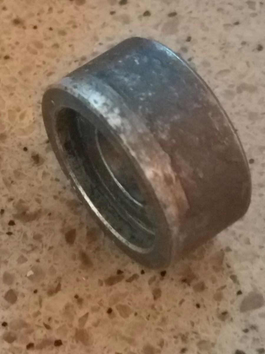

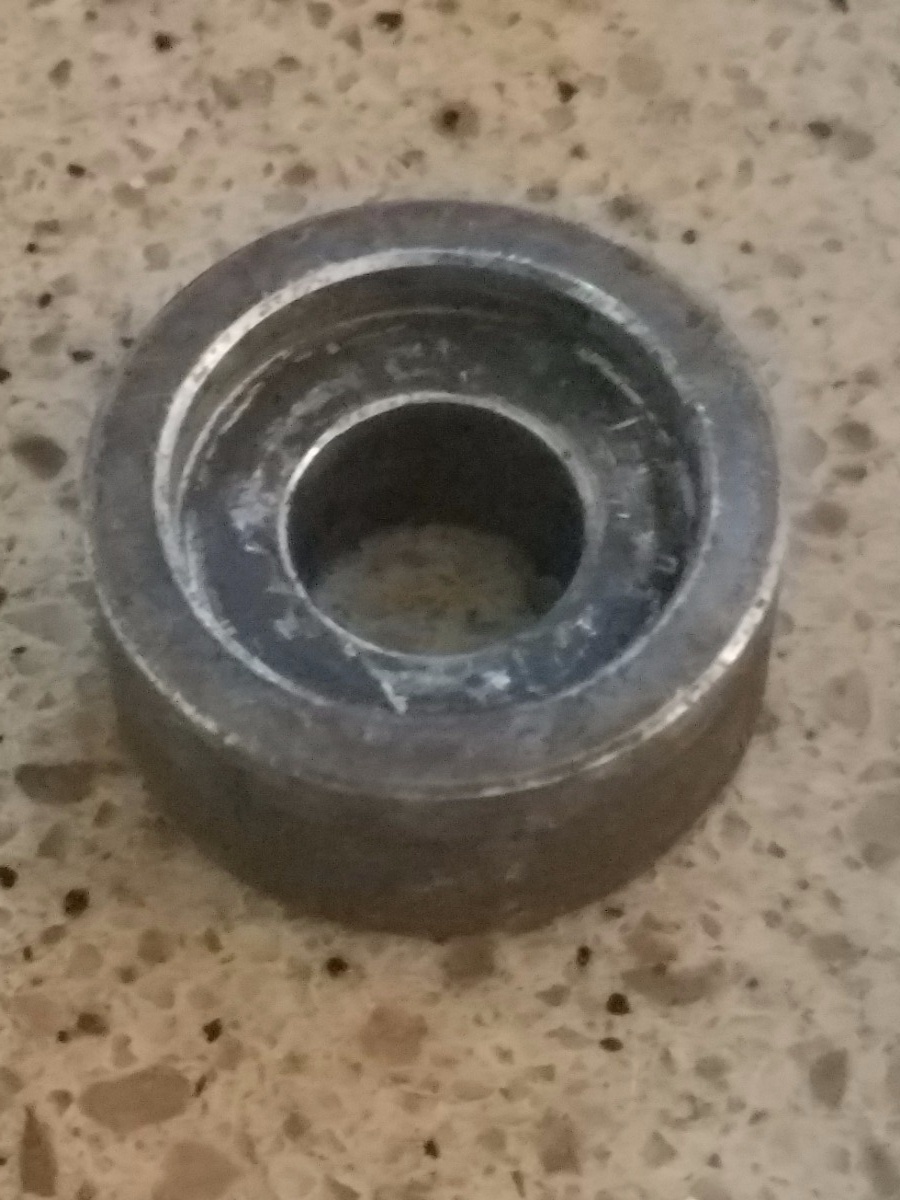

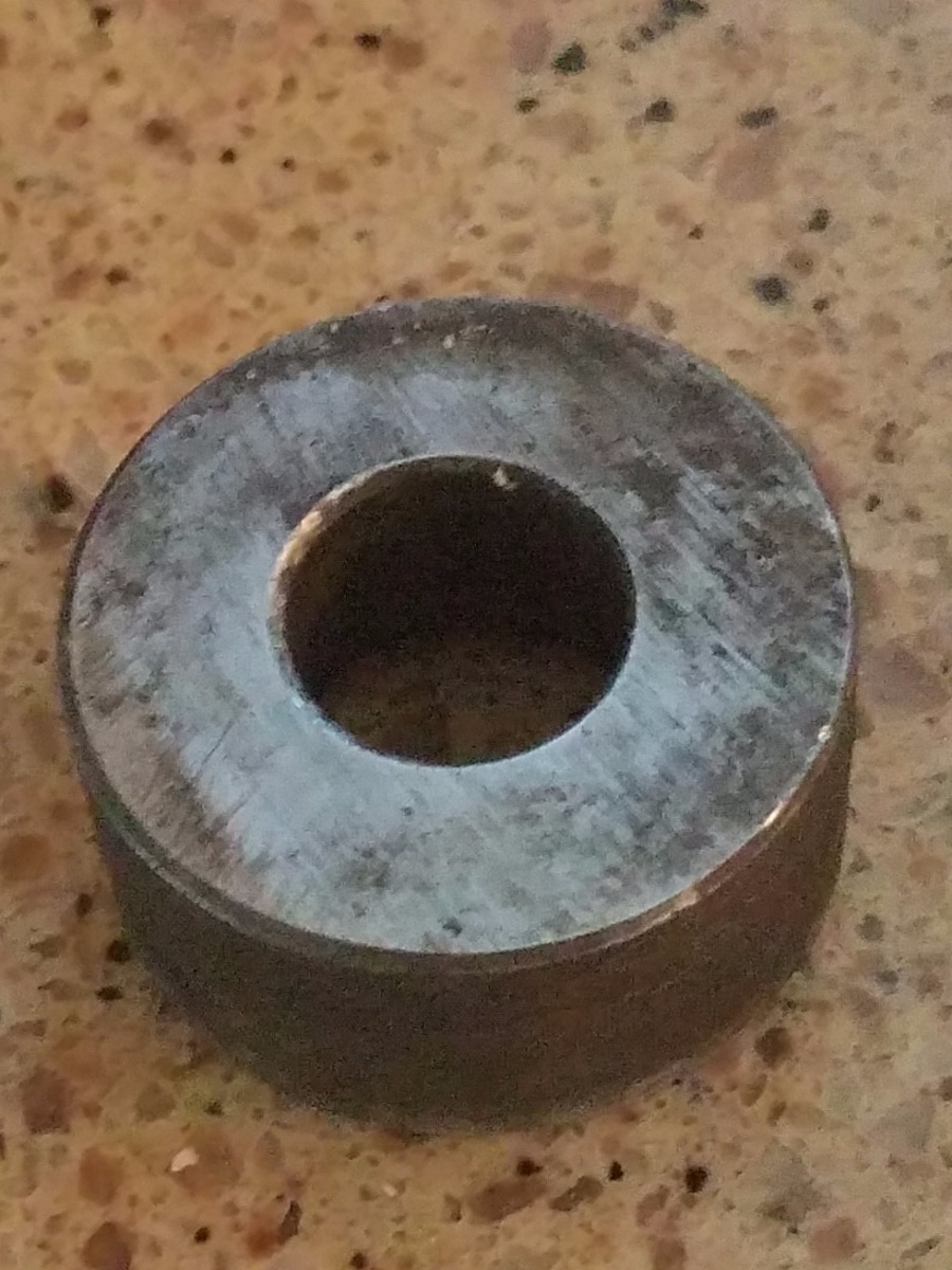

I just took my wheels off to have new tires put on them and in the bucket i had the parts in had a extra part and I am not sure if it goes on the rear hub or not. I have the factory service manual and I can not see the part in any of the wheel brakedowns.i will start taking pictures

Looks like a wheel spacer probably on the sprocket side.

It is in the signature line. 1982 kz750 car m1. I thought that too but it would not fit and what I ha e on there seems to have the wheel centered correctly.

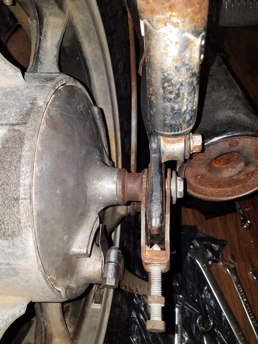

That looks like the sprocket side collar. In your last photo next to the left side chain adjuster there appear to be 3 large washers where the collar would go. I can't tell if those are washers in your pic or what. ...

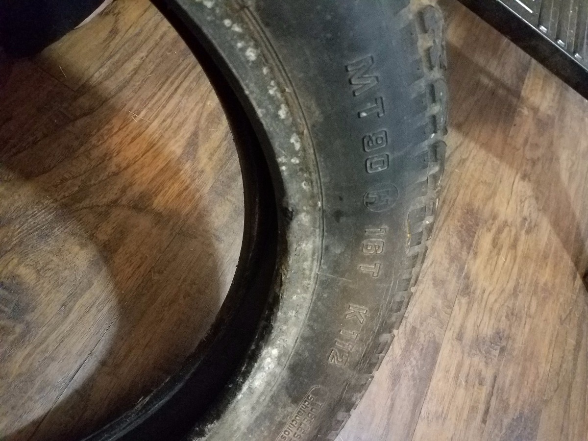

That is where I was trying to put it but it would not fit in but I will take it apart and put it in correctly. You are right there is 2 washer and the axles adjustment nut that is turned down. I will put the castle nut on the right side. There is new brake shoes in the rear. The pads had rusted to the hub and when I took it apart it separated the shoe from the lining. I am slowly going through everything and replacing what is stuck, rusted or just looks really scary. As soon as I get some time I am going to start a build post . The bike sat up so long the rear tire was discontinued and they just started reproducing it. It is a continental mt90 16t k112.

In your pic what's to the right of the 3 big washers? Are you using a parts diagram to assemble everything?
From the diagrams at Partzilla your bike has the same rear components as my 81 650-CSR.
The oil seal is right next to the collar. Below is the only pic I have. you can see the collar, but not the oil seal.

Thanks to everyone. I was able to get it put together correctly
