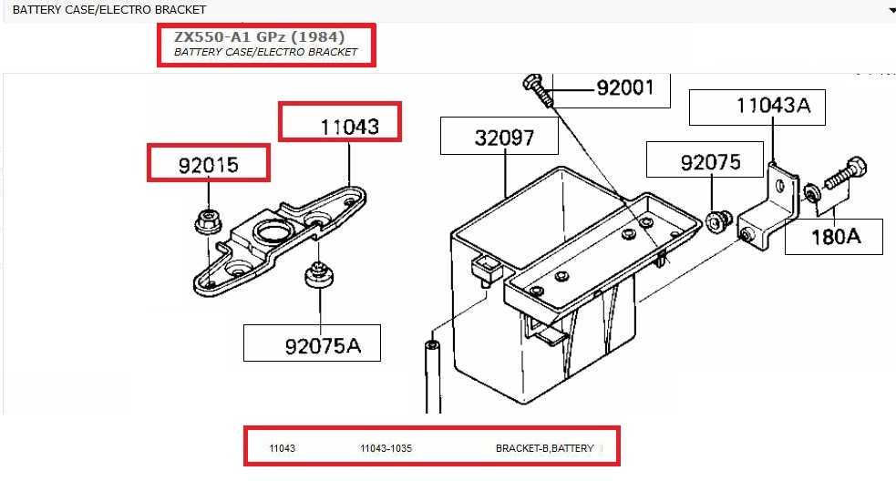

31 May 2017 15:22 - 01 Jun 2017 05:48
#763182
The US models do have GPz550 emblems on the side covers. I was thinking the 84-85 models would be quite a bit different than the earlier 550s, but they're kind of similar to the 82 & 83. doh.
In the battery bracket diagram, please note that there are a couple of dampers (92075A in the drawing).
I searched the bracket part number 11043-1035 & also did a couple of other searches on eb, but didn't find one.
cmsnl.com has a photo of the bracket in their diagrams.

Martin_csr., thanks for looking. I've also searched ebay.com and the german ebay, and dutch advertising sites (compare it to craigslist).
But i found some stuff with a dutch motorcycle salvage company. They have the battery bracket (and some other brackets I don't really need). And they also have the left sidepanel with GPZ550 emblem in the right colour. just what I was looking for.
I'll pick it up this saturday before it's gone, because this guy only has one left. They ask € 40 ( $45) for it. I'm happy :P
