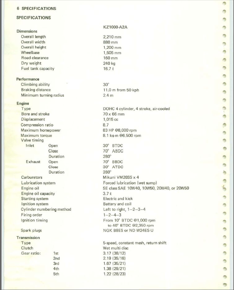

How exact it must be?
It should be less or equal than 240 kilograms
I hope it will help what are you searching for
Michael
Michael

The 240 Kil equals 529lbs dry add.... just under 28 lbs for 4.4 gal gas ... 7lbs for just under a gal of oil and maybe 2 lbs for fork oil and brake fluid and it comes to 565-566....... header again guessing at 16 lbs off could be more due to 9er's weights.... A friends 1978 1100 Yamaha knocked 30 lbs off with a Kerker years ago...... a stock front disc rotor (KZ650) weights 6lbs 0oz on a postal scale I have ....a extra caliber without pads that weighted 3lbs 12oz....... drilling the disc R/C engineering style 108 3/8 holes took 1 and 1/4 lb off mine according to a scale at a grocery store near the machine shop. Need to Add 2-3lbs for the pads and lines too for the extra brakes.
