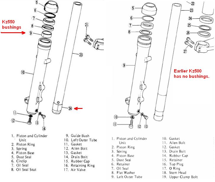

Some forks, like the 550, has a separate bushing under the seal. Maybe you are hitting up against that? You should be able to get at least 1/4" to 3/8" in before hitting the bushing.
Many KZ's don't have the bushing under the seal, but there may still be a washer under the seal.
