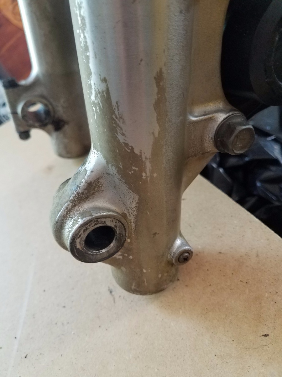

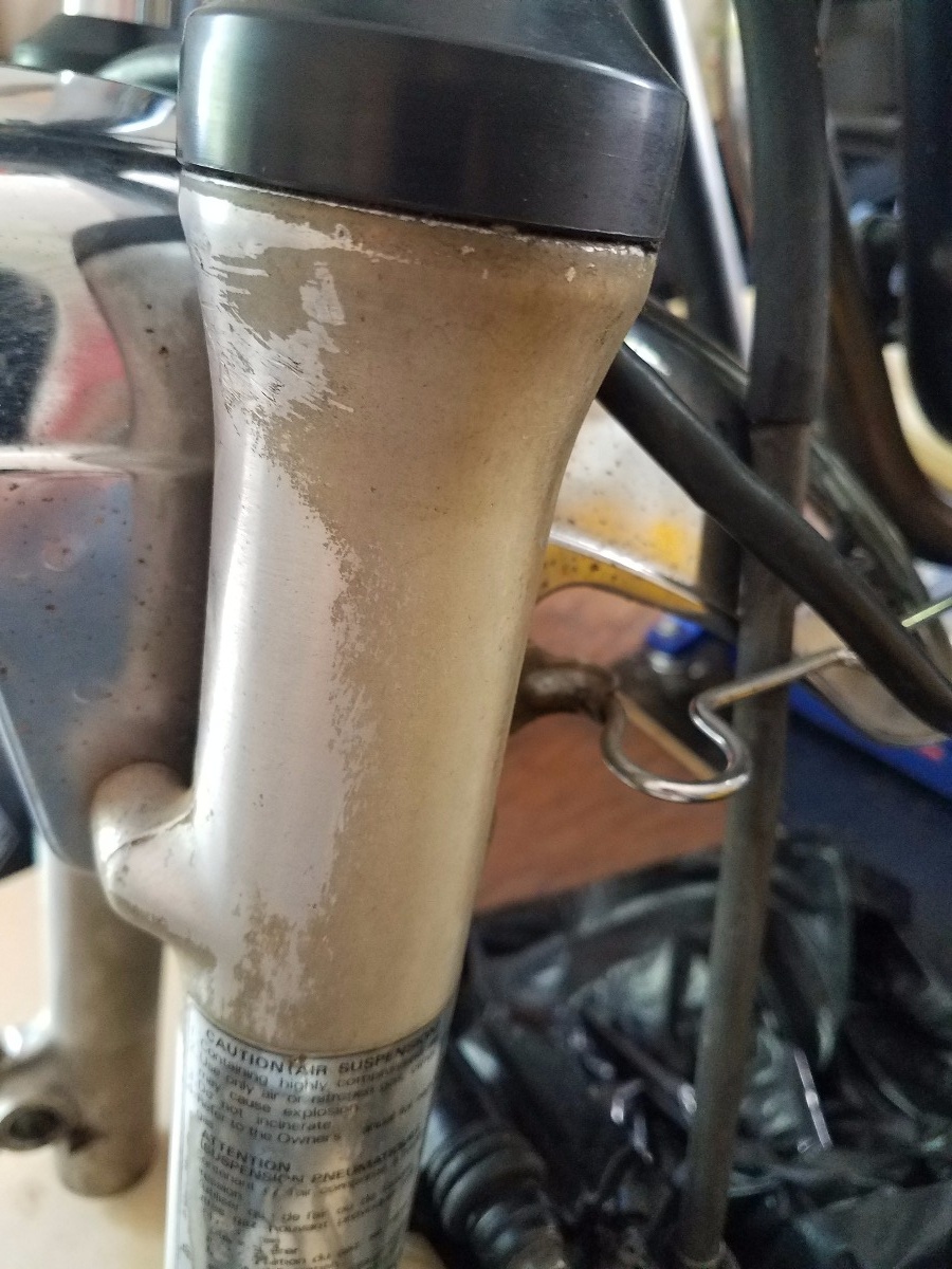

How do clean the lower half of the forks without scratching them? There is a layer of dirt and road grime , I believe. Pictures attached.

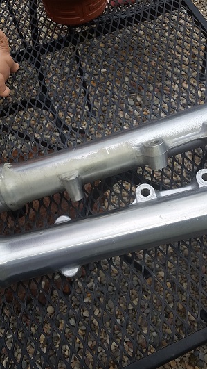

My fix wasn't too expensive but it wasn't easy. About 20 hours of work to wet sand them from 220 grit to 2K grit. Then buff them with buffing wheels and compound. I got the kits from Eastwood.

The acetone strips off the peeling plastic coating 9er? Assuming that is what you are showing us. No doubt that will make them look much better. If the bare aluminum has oxidized that will remain, correct?

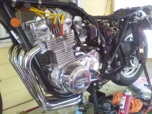

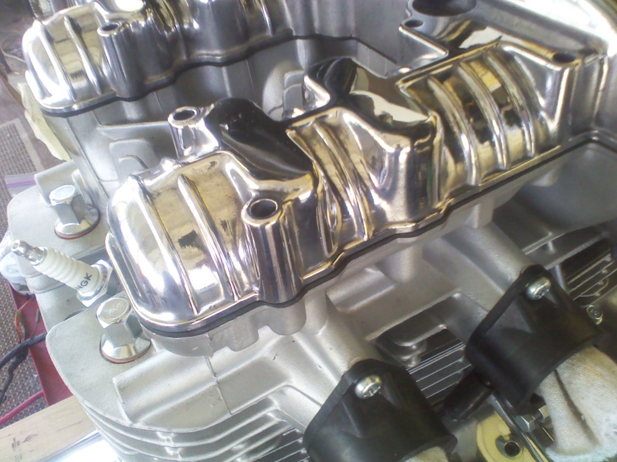

over 20 years ago I buffed all my covers and forks and just kept it clean, with mothers and neverdull occasionally. As long as no build up or standing water Thats all you need really. The forks I posted are from a 781000 Im putting back on the road has factory finish for now and all the dirt will hang in the finish, but for now it is what it is I go through Rio Grande Jewelry .com for my supplies. very helpful people. but the main thing is keep all wheels for different compounds and sanding supplies in seperate baggies and every thing free of residue, and clear of soap. Have fun getting the scratches out of the scratches out of the scratches on the full surface so no ripples appear. Good Luck.

Thank you all for the responses. Sorry I should have searched first and I probably would have found the post on cleaning them. If I understand it right the acetone will take off the factor clear coat?

If you are going to do the 220 grit sanding and progressively go to 2000 grit followed by polishing you can skip the acetone as the 220 grit will cut thru the yellowed clear finish and save you one step
