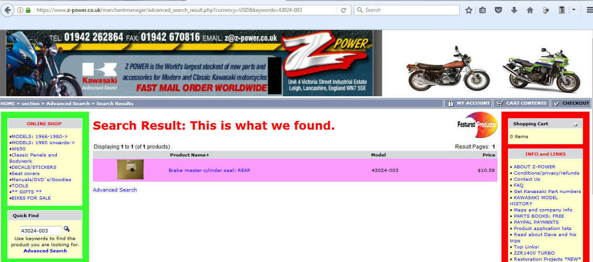

28 Apr 2017 13:53 - 28 Apr 2017 13:53ezrider714 wrote: Well Ed it looks like those links give me the same issue I ran into last night in my searches, When finding the correct P/N's The availability is always 0.........
Help me to understand. Here's what I get on the second link, but I don't see availability as being zero. Ed

Re: 650SR Rear Master Cyl Rebuild Kit
28 Apr 2017 14:06
The page I got using that link was an England page, for lack of a better word, price was in pounds, International shipping? etc
That's the same as 0 to me, unless I have exhausted every other option. My page did not look like your screenshot???
Nessism's comment's have me in a holding pattern at this time

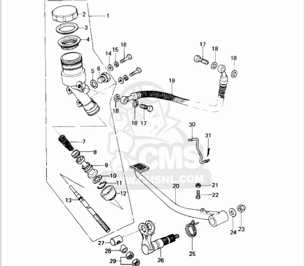

28 Apr 2017 14:14
Rear Master Cylinder/brake Pedal schematic Kawasaki Kz650d2 Sr 1979 Usa Canada
www.cmsnl.com/kawasaki-kz650d2-sr-1979-u...t/57224.html#results
