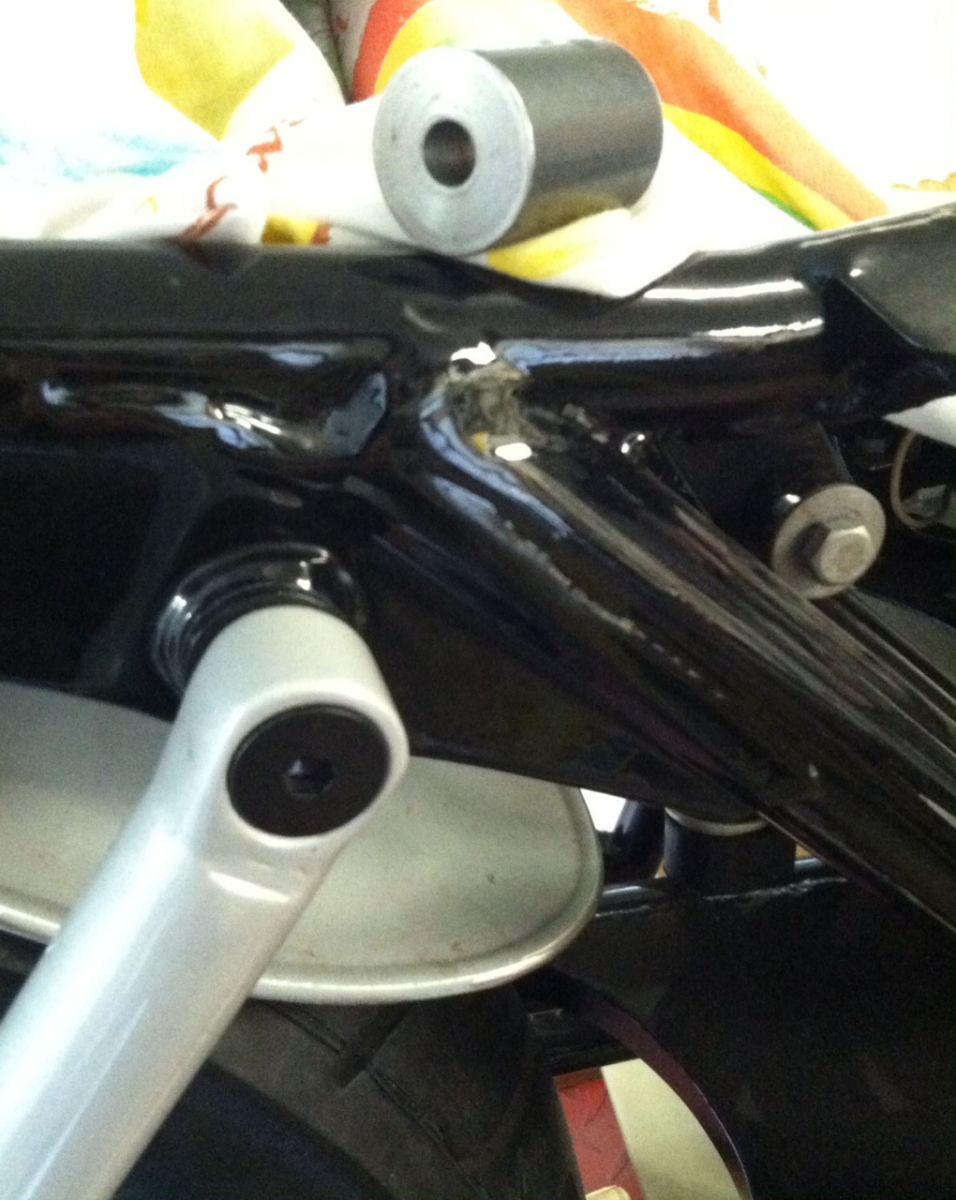

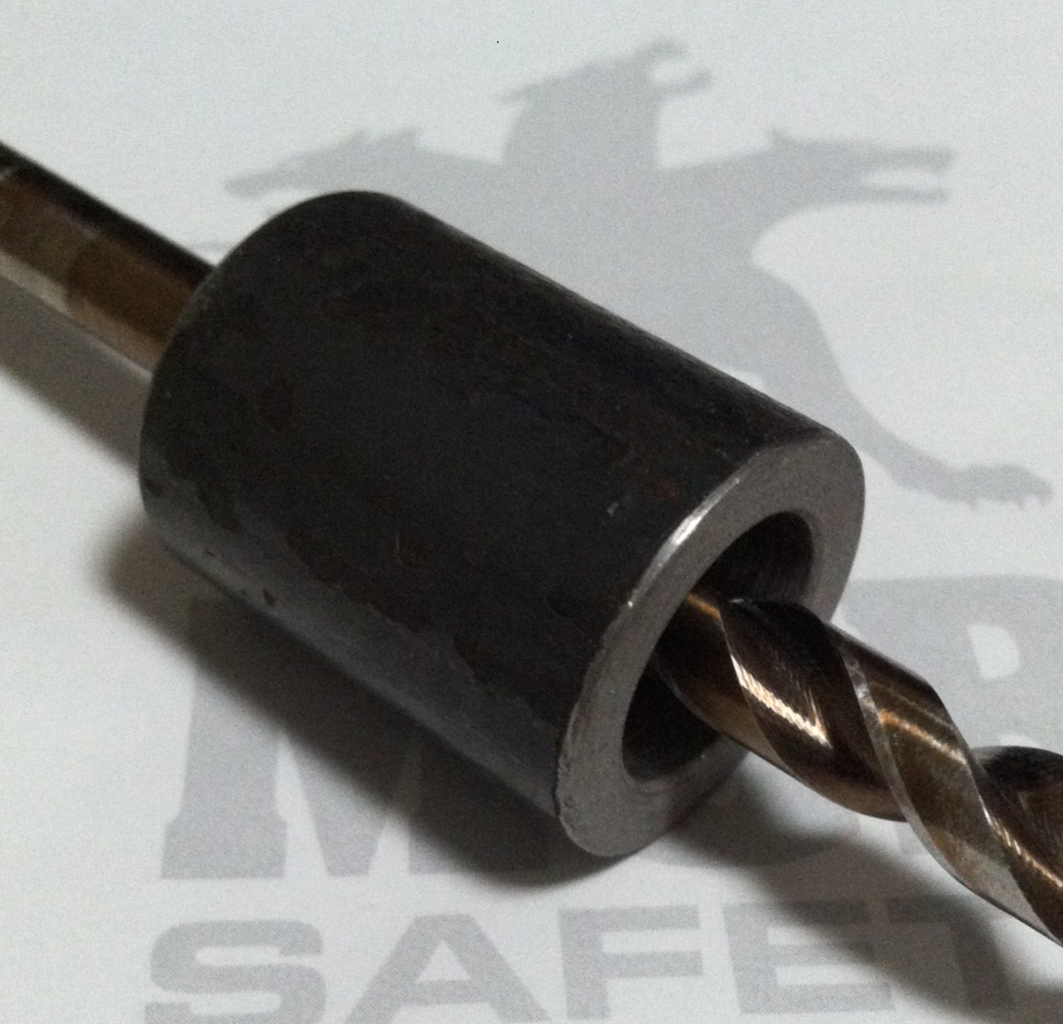

NO GO! Those studs are welded in place. You can modify them. I have done this on an old project. I cut the stud off flush.
I made a jig to drill a hole in stud. 1 side is 14mm that slips over stud. And the opposite side is a 5/16" hole for a drill bit.
This way the drill goes in straight. all the way through is about 2 inches. I just drilled and tapped a 3/8" thread in. I did not go all the way through. I have a bunch of flat heads on this old bike Countersunk in these aluminum struts. But you would need a machinist to help you. A nice quality drill bit or 2 and a good high torque drill. The frame metal is soft enough. couple pics from phone.
