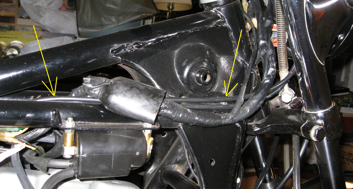

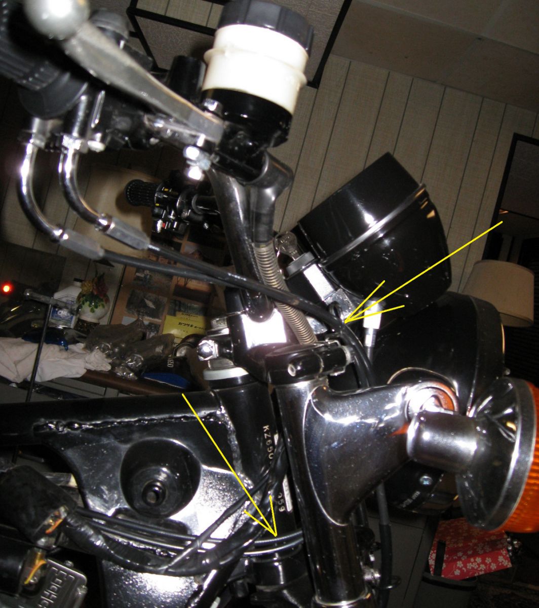

Dumb me removed the old throttle cable without remembering the path it was ran I went to replace it with a new one and I get no tension or it pinches when I turn the handle bars left. I'm new to working on bikes and need a picture of how to run it and adjustment tips. The new one seems to be only a little shorter than the old one. If someone could drop a link for the correct cable that'd be useful as well.

Here's how they're routed on my KZ650. I suspect the 1981 KZ750 would be similarly routed. Ed

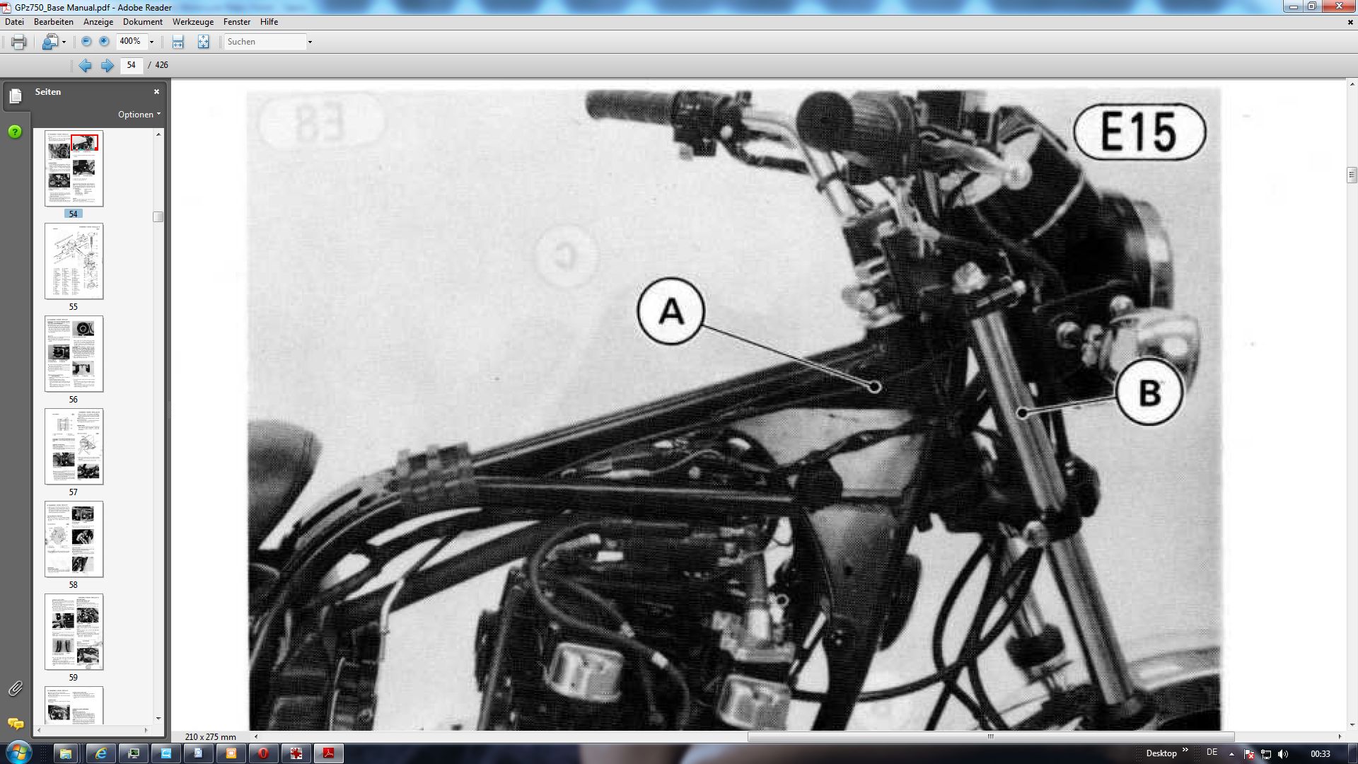

Hello lucasr225
As first aid
"A" is the throttle cable
650ed is right, routed the same way
Michael
