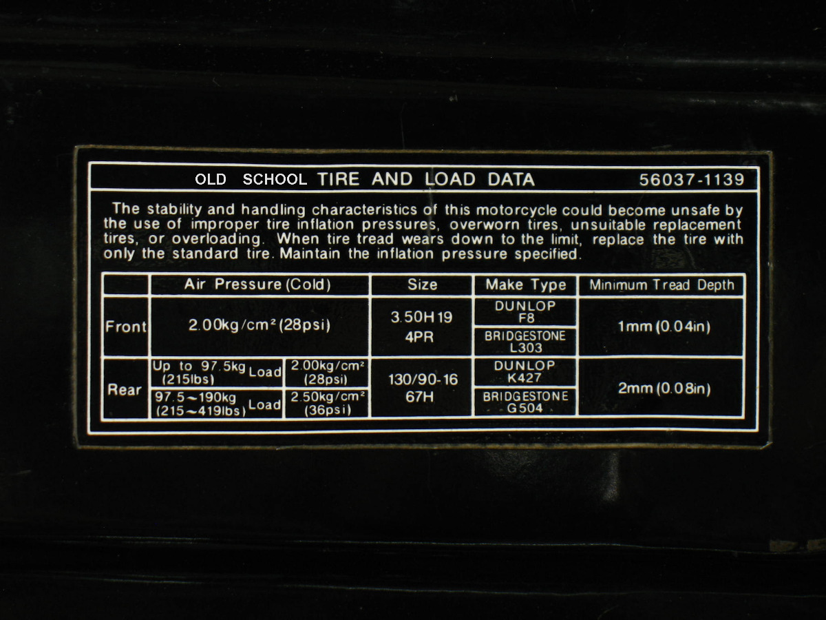

I believe you will find the pressure marked on the side indicates the MAXIMUM pressure for the tire. That generally is not the correct pressure for the bike. The correct pressure for the bike should be printed on a label on the bottom side of the stock seat and in the Kawasaki Owner's Manual. I would never run 40 PSI in my front tire. I generally follow the instructions and run 28 psi up front and 34 - 36 psi in the rear tire. Ed

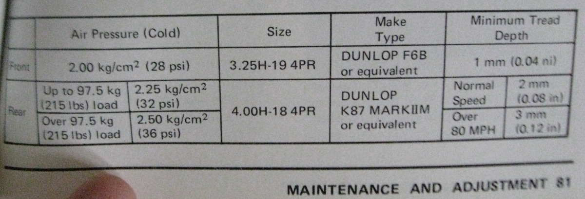

What does the sticker on your seat say and manual Daveo...... I was surprised to see mine states 28F/32 rear 4 less than Ed's 77 650C ..... I trust the engineer's at Kawasaki and have good luck over the years so will stick with that.
