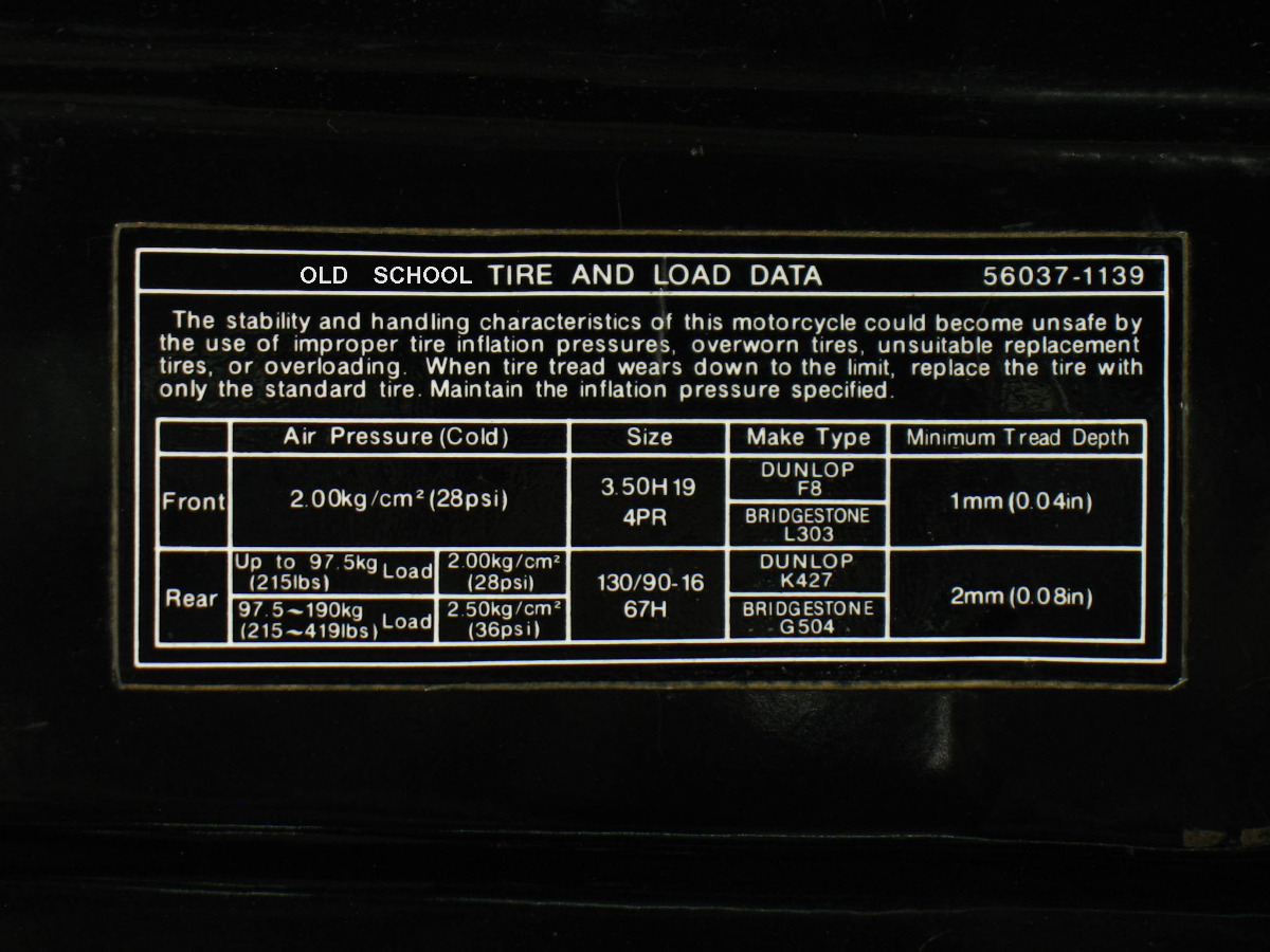

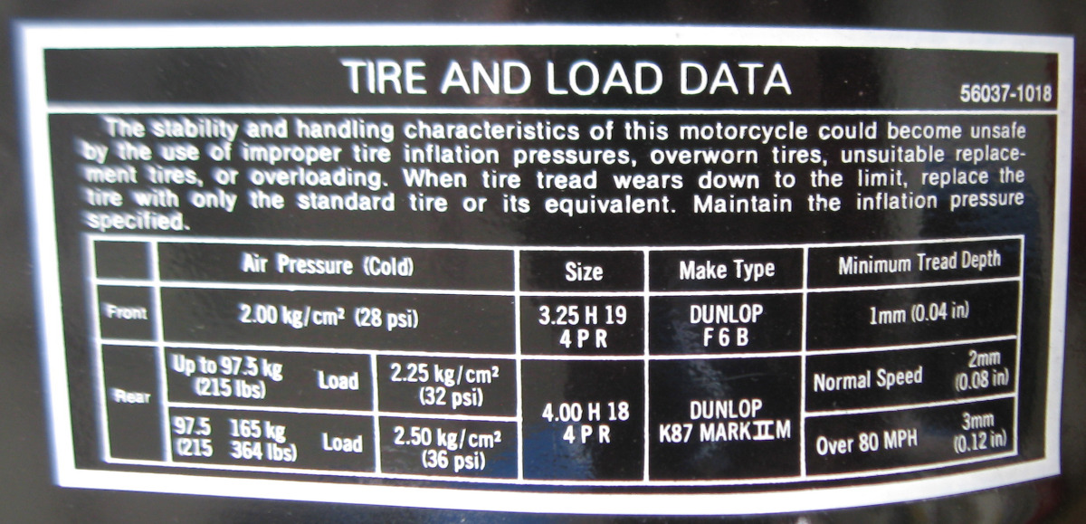

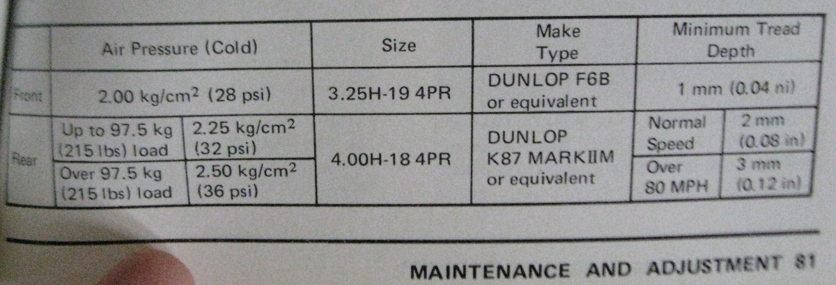

I believe you will find the pressure marked on the side indicates the MAXIMUM pressure for the tire. That generally is not the correct pressure for the bike. The correct pressure for the bike should be printed on a label on the bottom side of the stock seat and in the Kawasaki Owner's Manual. I would never run 40 PSI in my front tire. I generally follow the instructions and run 28 psi up front and 34 - 36 psi in the rear tire. Ed

What does the sticker on your seat say and manual Daveo...... I was surprised to see mine states 28F/32 rear 4 less than Ed's 77 650C ..... I trust the engineer's at Kawasaki and have good luck over the years so will stick with that.

Those pressures are for old school Dunlops

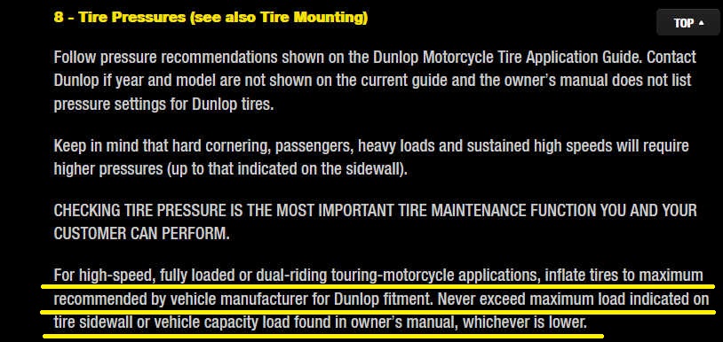

Some tire manufacturers have recommended pressures listed on their websites and catalogues. The max listed on the tire might be ok for max load at sustained max speed, but otherwise useless.

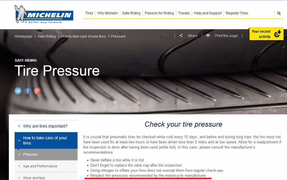

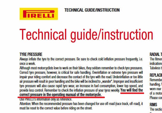

To my knowledge all motorcycle tire manufacturers recommend using the tire air pressure specified by the motorcycle manufacturer. I use Pirelli Sport Demon tires. These are modern tires made for non-radial rims. In the past I used Michelin tires. Below you will find the tire pressure recommendation from their respective web sites. Notice they both state that the tire pressure specified by the motorcycle manufacturer should be followed. I don't know of any motorcycle manufacturer that recommends using the maximum tire pressure molded into the tire sidewall for normal street use. Ed

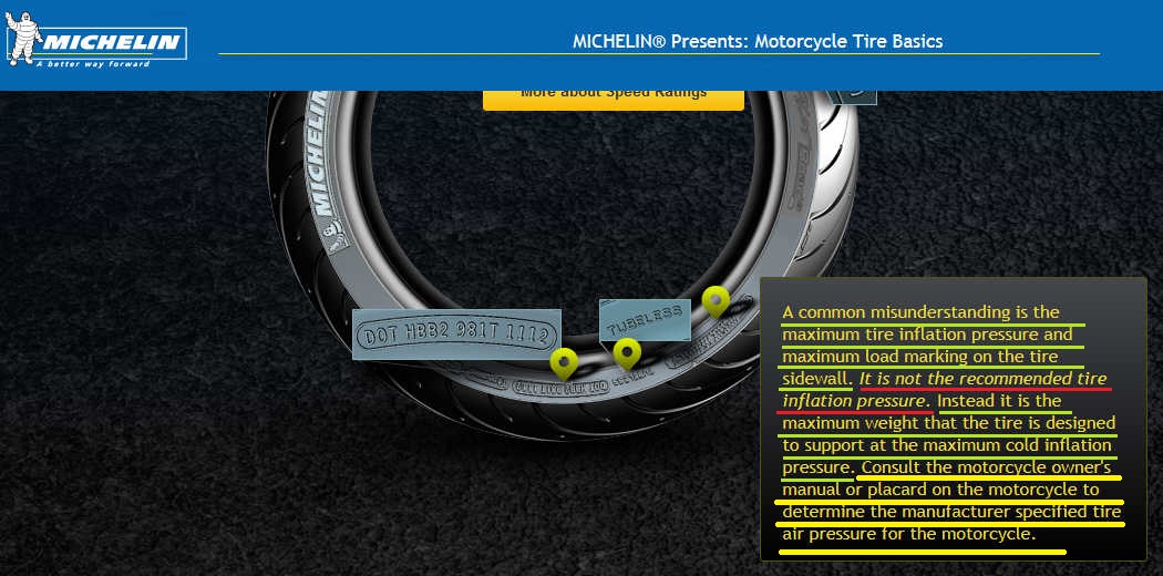

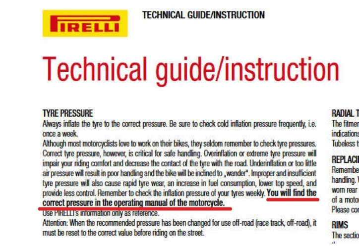

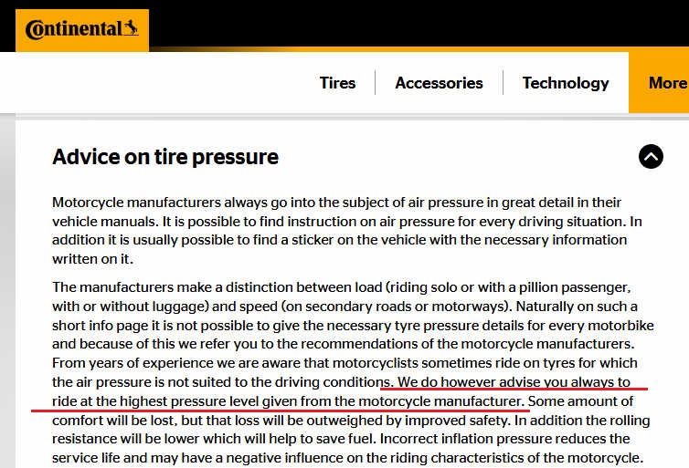

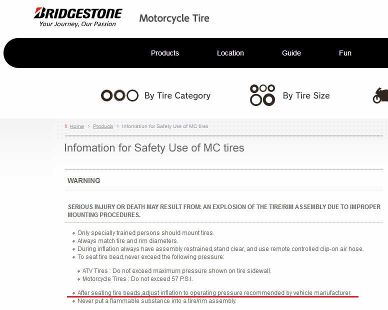

NOT TRUE!!!! I don't know where you got that info, but it is totally bogus!!!
Metzeler and every other major motorcycle tire manufacturer recommends following the tire pressure recommendation of the motorcycle manufacturer. Many folks believe the old wives tales, urban legends, myths, etc, about using higher pressure in new tires on old bikes, but the fact is that the tire pressures for new tires are the same as those of old tires for the same model bikes. Here are images from the CURRENT web sites of motorcycle tire manufacturers. The tire manufacturers have a vested interest in ensuring their tires perform as well and as safely as possible, so they have no reason whatsoever to lie about what pressure to use. Ed
