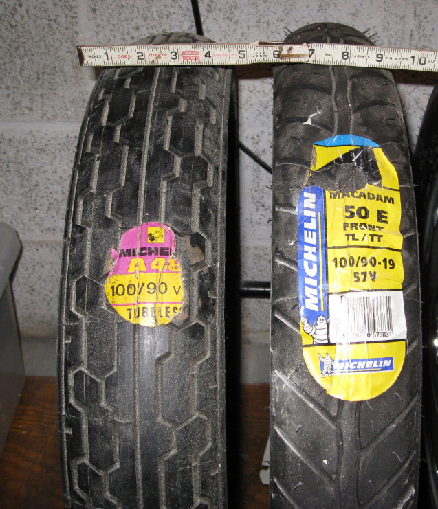

One other observation on tires -
The sizes marked on tires do not always accurately represent the width of the tires. One should be correct in assuming that all tires of a particular size will be the same width, but unfortunately that is not always the case. Sometimes a tire will be wider or possibly narrower than the size would indicate. The image below shows two Michelin front tires. The tires are from two different time periods and are two different models, but they are both marked on the sidewalls and labels as being 100-90/19 Front tires. Notice the old Michelin A-48 is significantly wider than the much newer Michelin Macadam 50E. Incidentally, the old A-48 tires performed GREAT whereas the newer Macadam 50E tires were about the worse that I ever tired on my KZ650-C1 in 40 years of ownership. Ed
