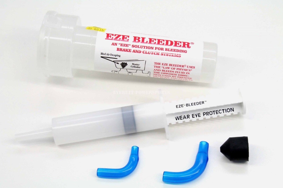

Has anyone ever used one of these ? Purchased some New SS Lines for my 77' KZ1000A and like to see if there's a better way to bleed brakes.

Just my .02, but I''ve tried some of the suction type bleeding assists, and have never been particulary thrilled. The more expensive ones some of my well set up mechanic friends have do a great job, but are a bit of an investment. Not that $20 is much, but is IS just a plastic syringe with some rubber tubes.

I haven't used that brand, but I have used a syringe / tube to force fluid back thru the system via the bleeder valve. Z1R's have a remote M/C and are notoriously difficult to bleed. I spent days trying to get good lever pressure. Forcing fluid back thru the bleeder valve finally did the trick. Watch your M/C reservoir level. You'll be filling it from the bottom and it's easy to overflow. I started with a fill from the bottle of brake fluid, then refilled the syringe from the reservoir. Keep going until there's no more bubbles coming up in the M/C reservoir.
