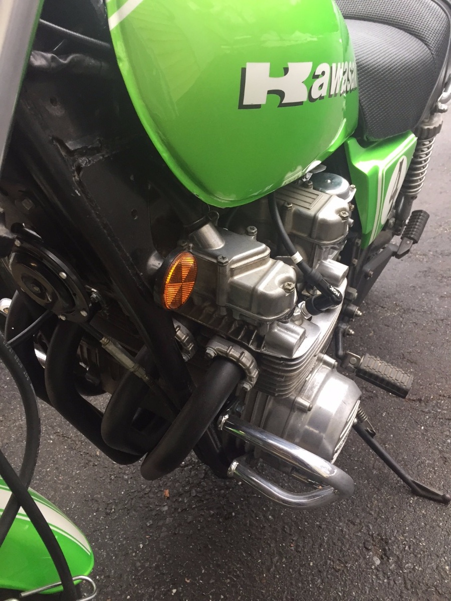

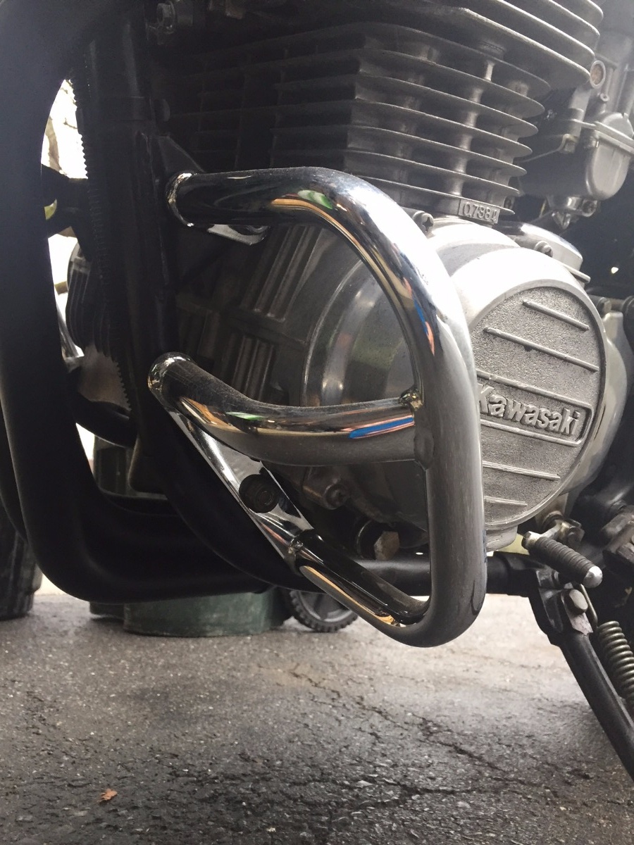

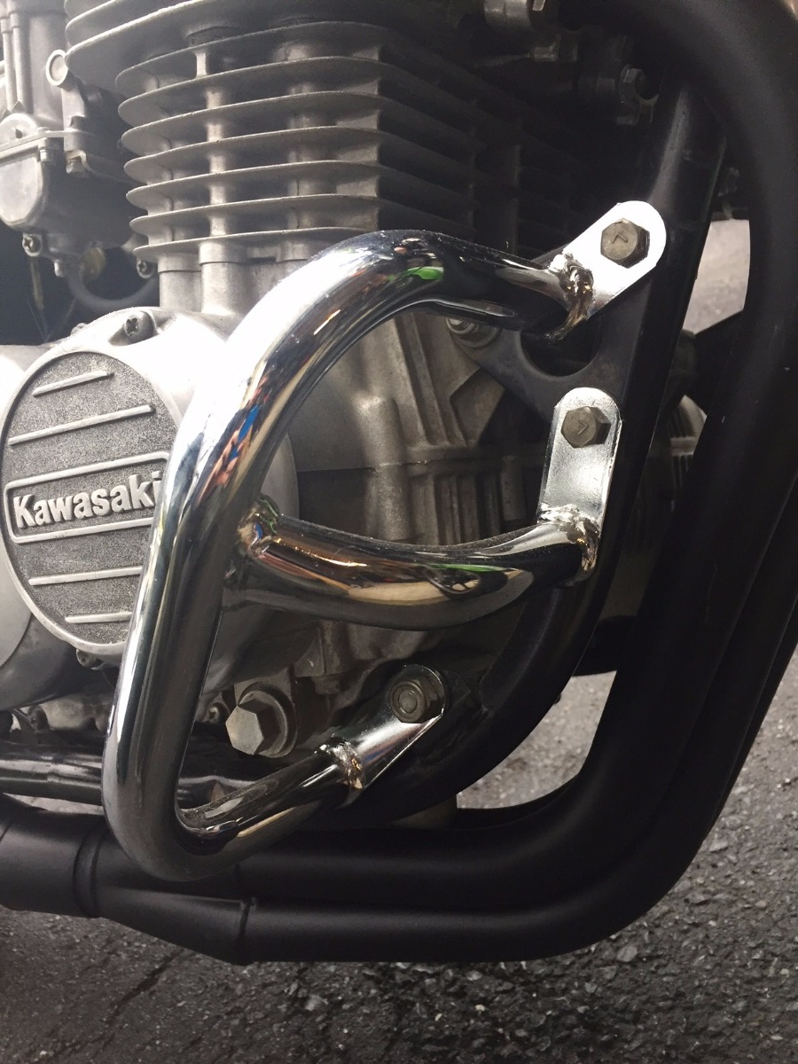

Not sure if you got what you needed yet but I came across this post and figured I could shoot you a few pics.
1980 KZ750 LTDx2
1978 KZ1000 LTD
1976 KZ900 A
1978 KZ1000 LTD
1976 KZ900 A
