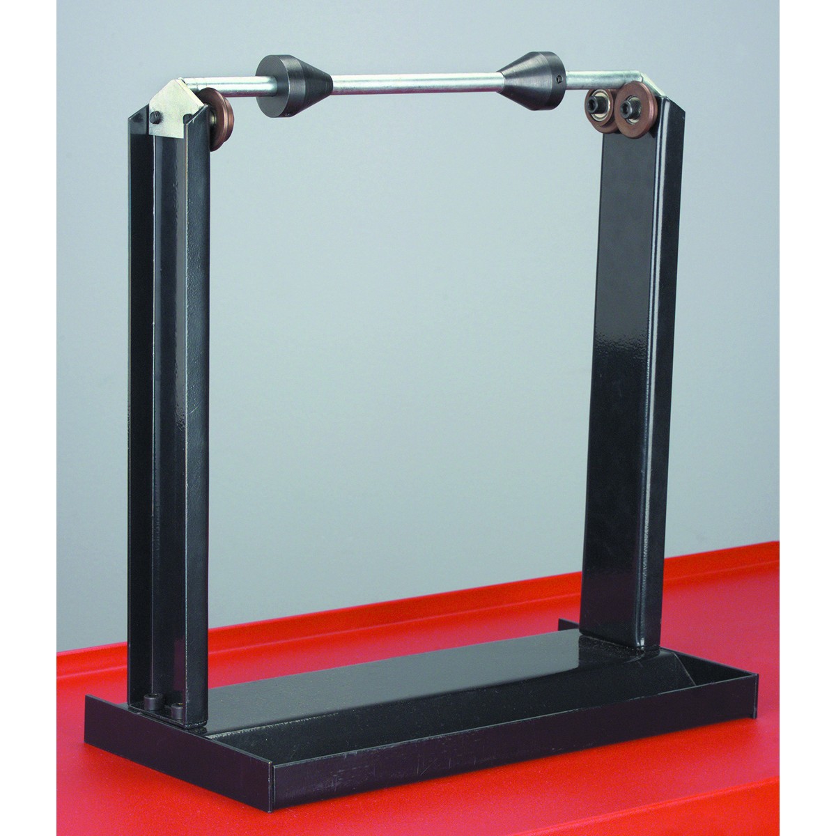

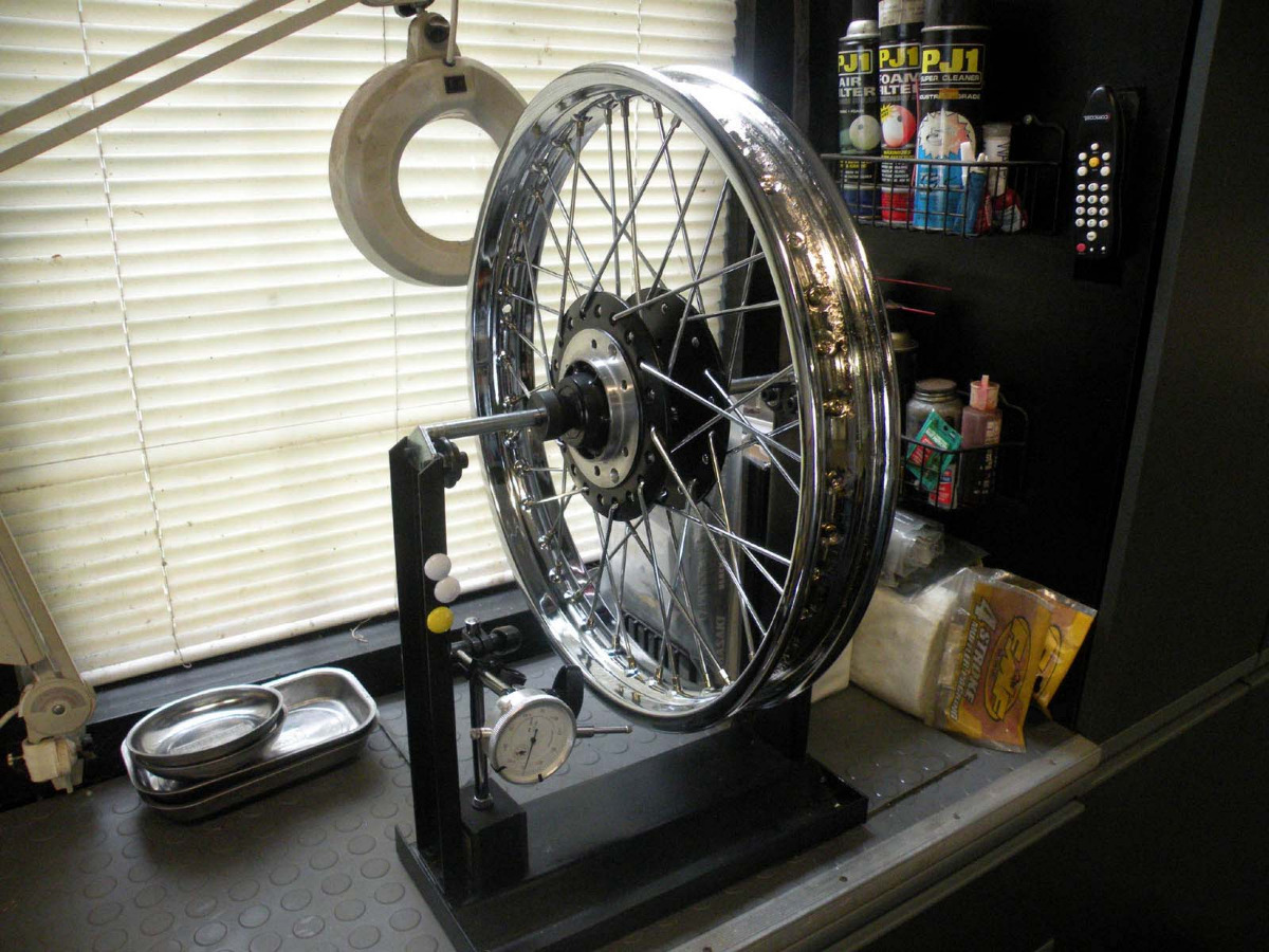

Do you notice the run out when riding the bike? If not, leave it alone. You can "true" the wheel by loosening/tightening the appropriate spokes. You can also make it far worse. If these are the original rims, there's a good chance the nipples will be corroded and froze. You really should start with removing the tire and soaking the spoke threads with a penetrating oil from the inside of the rim. Truing is not rocket science. Loosen the spokes on the opposite side (in relation to the hub) where the run out is highest and tighten the spokes on the same side to pull the run out closed. Work in small increments, no more than 1/2 turn at a time.

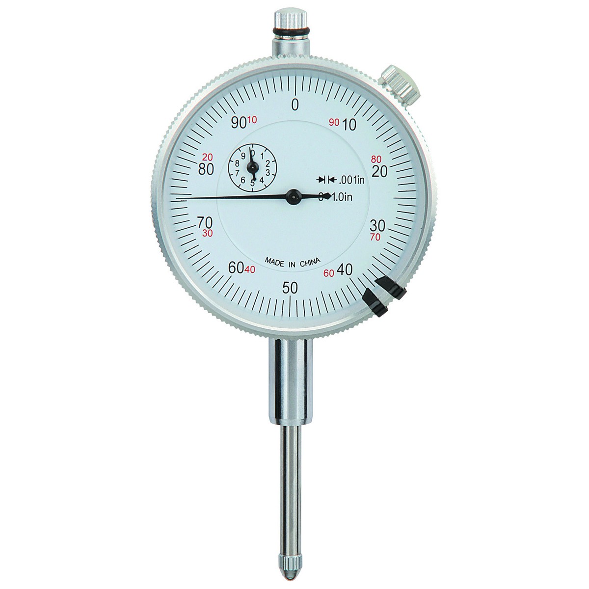

Besides a spoke wrench, you may want to invest in a cheap dial gauge and holder. HF has a them for under $20.00. Measuring run out with a fixed pointer and feeler gauges is going to be time consuming and not very accurate

MDZ1rider, I like your set-up . Dial you purchase Both Dial gauge and wheel balance stand at Harbor Freight ? I didn't see at HF if they had a gauge holder/magnet ?
77' KZ1000A
Last edit: 23 Feb 2017 10:01 by kzdcw.
- MDZ1rider
- Posts: 381
- Thanks: 118
Re: Wheel Runout Measured
23 Feb 2017 11:27
It's all from Harbor Freight. Some people are tool snobs and wouldn't buy anything HF. It's good enough for non-professional use and the price is hard beat. The little colored dots on the stand are magnets for a dry-erase board. I use them to mark the spots that need adjusting. It also works a balancing stand.
