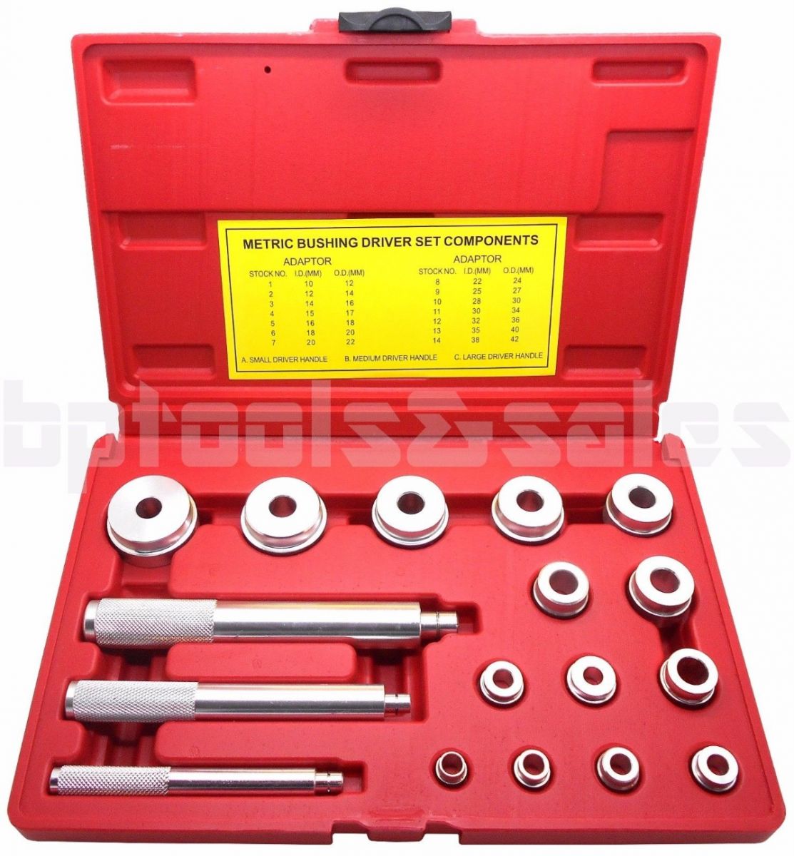

How about this bearing driver set ? Made in China but I'm sure it would do the job and at $21.99 a lot less expensive. Not sure if all the sizes in the kit would work in all applications ?
77' KZ1000A
Last edit: 16 Feb 2017 16:30 by kzdcw.

You'll need a set with some larger sizes. I have a Performance Tool 7-piece set without the fancy storage case. disks fit common bearing sizes. smallest disk = 1.565" & largest disk = 2.555". ... Before purchasing, I looked up the bearing part numbers at Kawaski.com, then checked the dimensions using the bearing charts at Dans mc repair course.
similar to mine but has 3 additional large sizes.
11 Pc Wheel Bearing Race & Seal Driver Set
