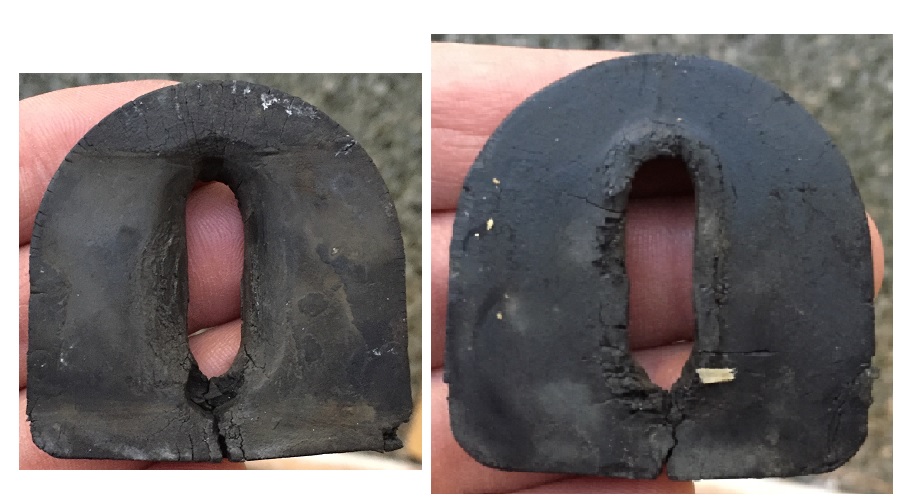

Hi,
I hope somebody can help me, I want to order a new rubber...
These rubber is under the tank for holdning the gas tank in correct posision.

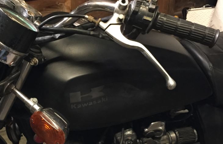

These is a Kawa 81 650, but when it look at the diagram it`s totaly different gas tank..
Please see attached picturs for rubber and tank.

That is Kawasaki part number 92075-295 damper, rubber. Kawasaki used the same damper on many different models to fasten the rear of the fuel tank. Not sure why Kawasaki doesn't show your model in the 1981 exploded diagrams...I'm guessing you have a 1981 KZ650-D4?

What is the VIN number of your bike (It's stamped into the steering neck)? You should be able to tell the model (at least of the frame) based on that VIN. Ed

The bike is probably a European model.
Model identification. jarlef z650 . or cyclechaos.com. or the KZ650.Info site.

The fuel tank damper is listed as PART OBSOLETE at Partzilla.
There are several nos & used listed on eebbaayy.
eb UK might have the damper as well.
92075-295 DAMPER RUBBER FUEL TANK

16 Jan 2017 13:50martin_csr wrote: The fuel tank damper is listed as PART OBSOLETE at Partzilla.
Buy the part via eBay...as Martin suggests.

Thank you all
I have now bought it on ebay
