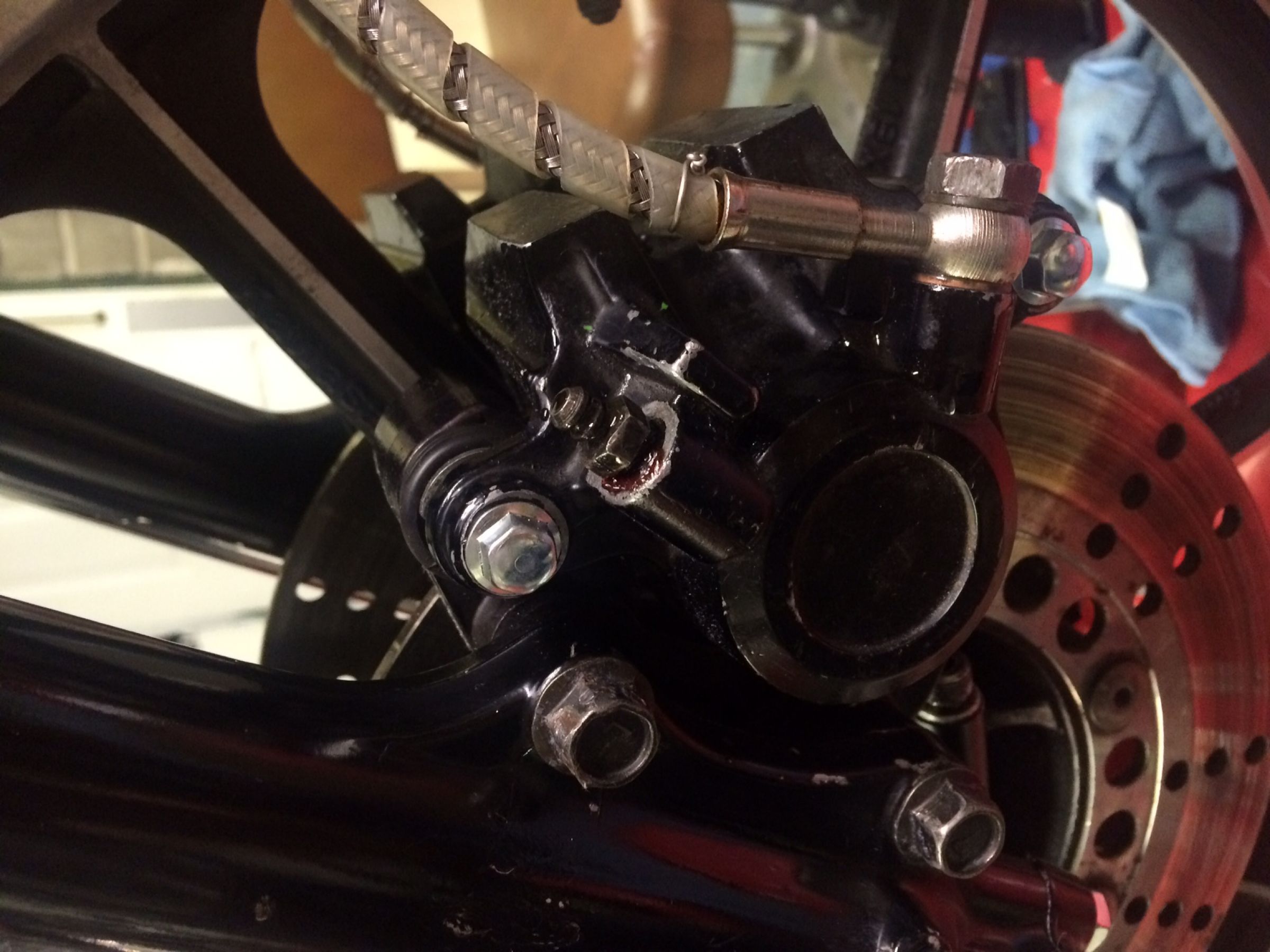

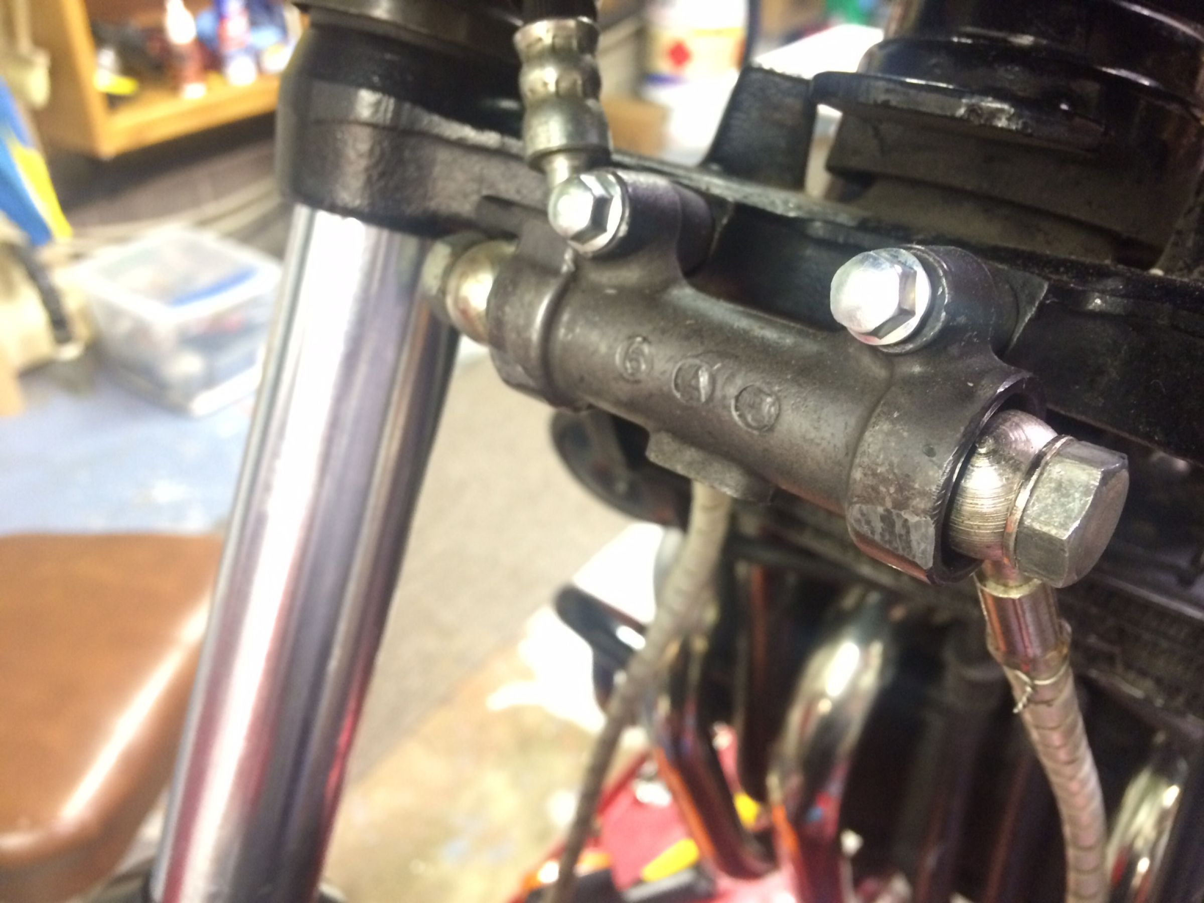

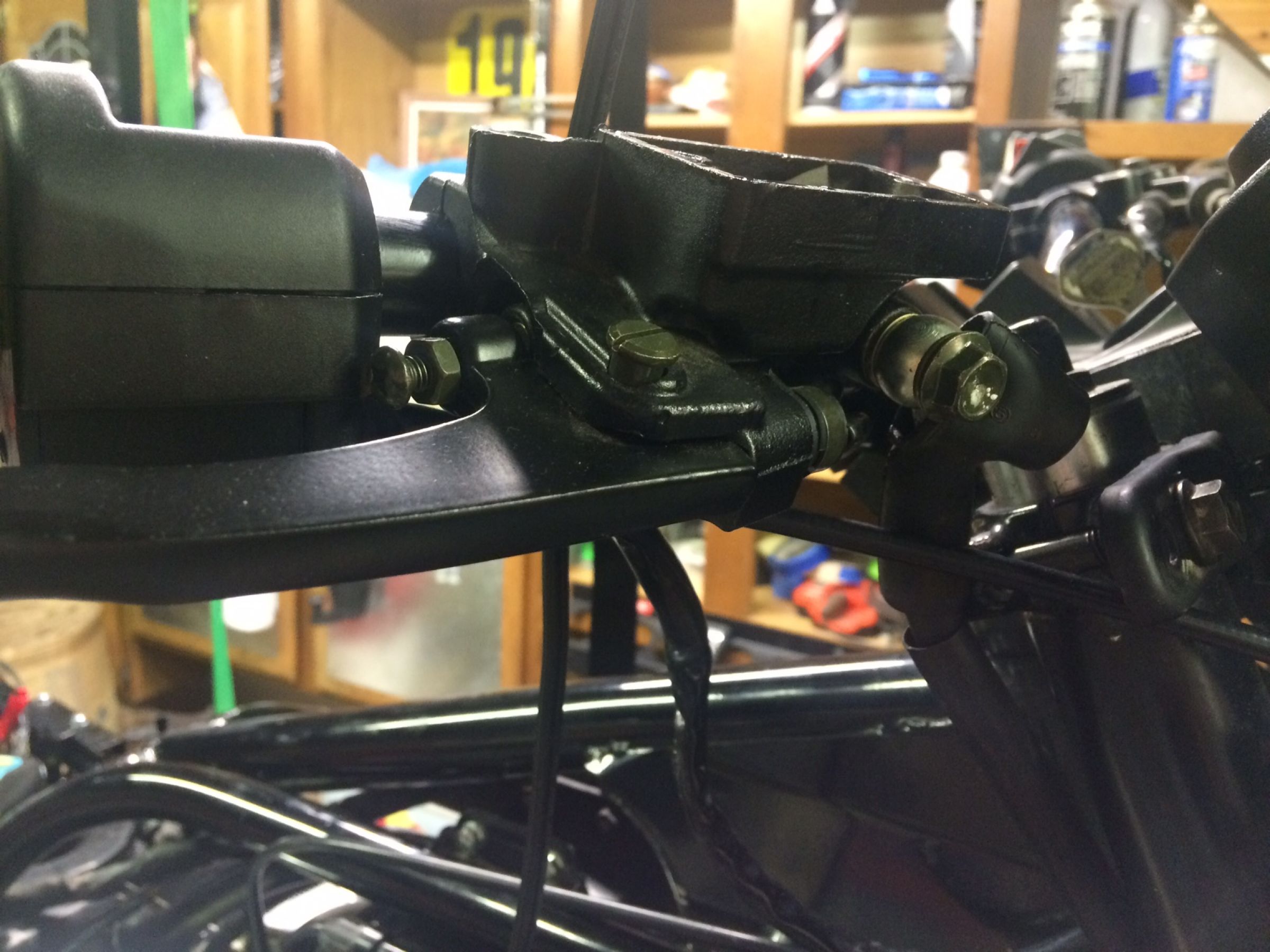

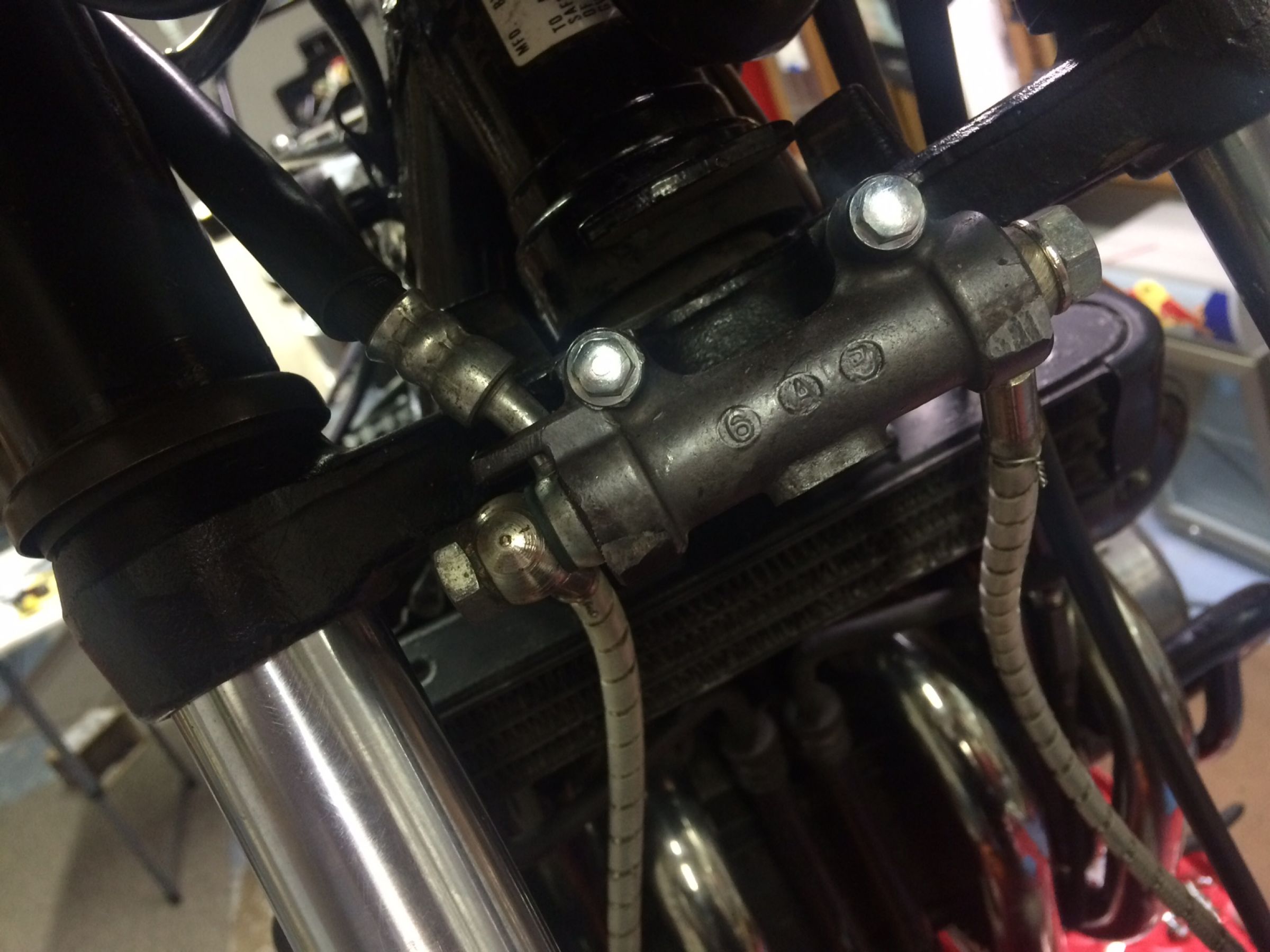

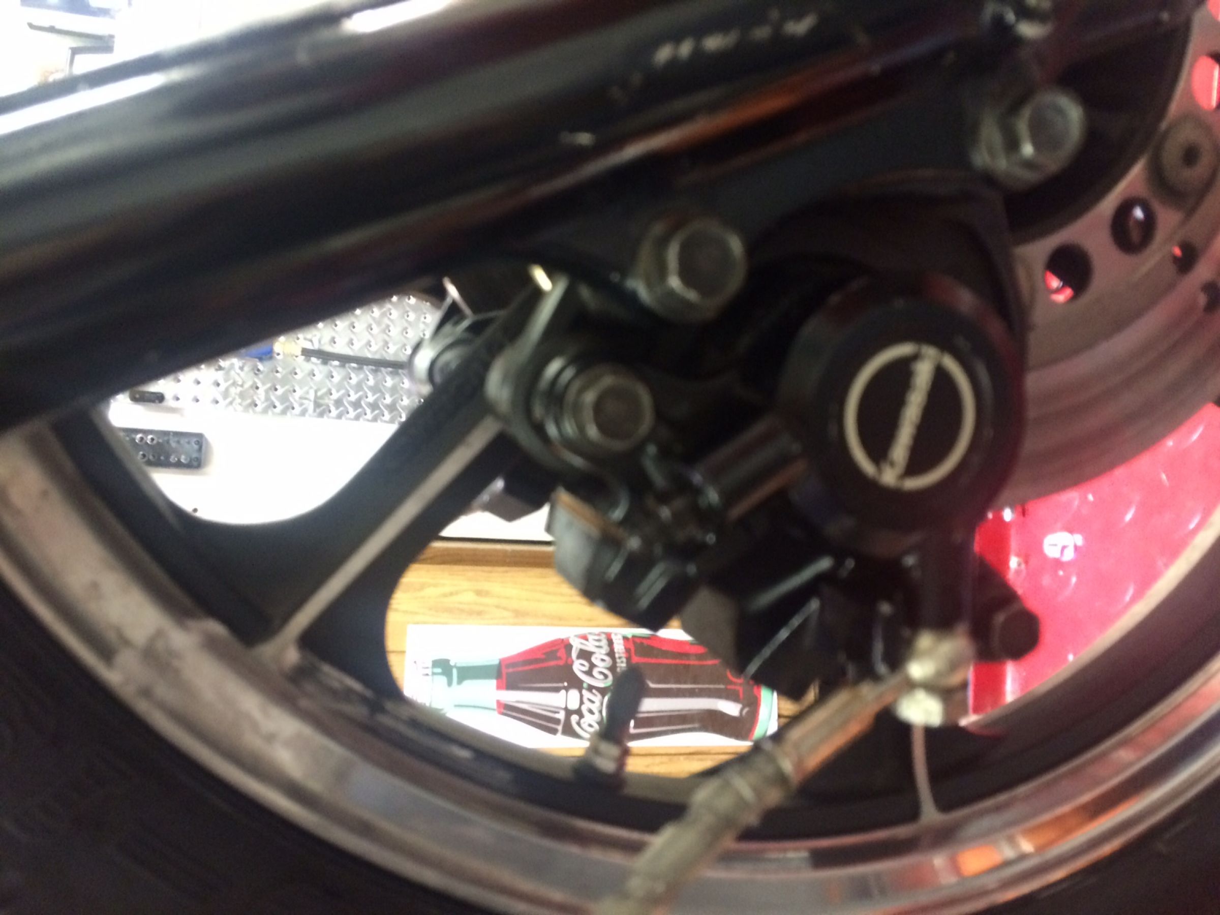

As I have noted in other posts I am putting my 1983 KZ750 L3 back on the road.
Things are going pretty well. But I am REALLY struggling to get any front brakes in it.
Calipers cleaned up by a known good Kawi mechanic.
New braided lines to the front block then old line to the master.
New eBay top/front master.
Does not seem to be sucking or leaking from anywhere but it will NOT build any lever pressure at all.
I am beginning to wonder ... I am confident that the calipers are good, the connections are good.
Thinking about buying a new front master and lines all the way to the master (two lines going straight to the master) with a new banjo on the master.
Pretty much my supply house is eBay. Can anyone recommend a good seller there for KZ braided lines, masters and the like?

Try reverse bleeding: just lift the reservoir top off and 'gently' squeeze the lever - you'll see bubbles rising up. Do this a few times, then bounce around on the forks and lean it side to side -you are trying to get the bubbles to float to the top.
Briaded steel definitely improves the feel -but assuming they have been rebuilt properly and it isnt MC or caliper seals your issue is air in the system.
WARNING cover the tank, frame and instrument glass, brake fluid will ruin eerything.

Typically what are you guys running for a replacement master cylinder. I think I am using a China version of a model for the Yamaha FZR600. Perhaps this is the issue as well?

You need to size the replacement MC to the calipers: 1/2 " or 5/8" from memory. Getting it wrong will give you either really 'grabby' brakes or too much lever travel...not your problem here.
I have been known to remove the caliper, put a bit of wood between the pads and bleed it - tapping the caliper and pointing the bleed nipple right at the top to allow bubbles to rise.

If you are getting zero resistance at the lever the master is not pumping. You need to get some fluid into the master bore, the pumping chamber so to speak. Once you get that flow started by "priming" the system the master will pump fluid downstream allowing you to bleed the system per normal.
For dual disc bikes like the L3 you want a 5/8" bore master. Some guys use a 1/2" bore master which will work too, only the hand lever will feel spongy, almost as if there is still air in the system, even after the system is fully bleed.
