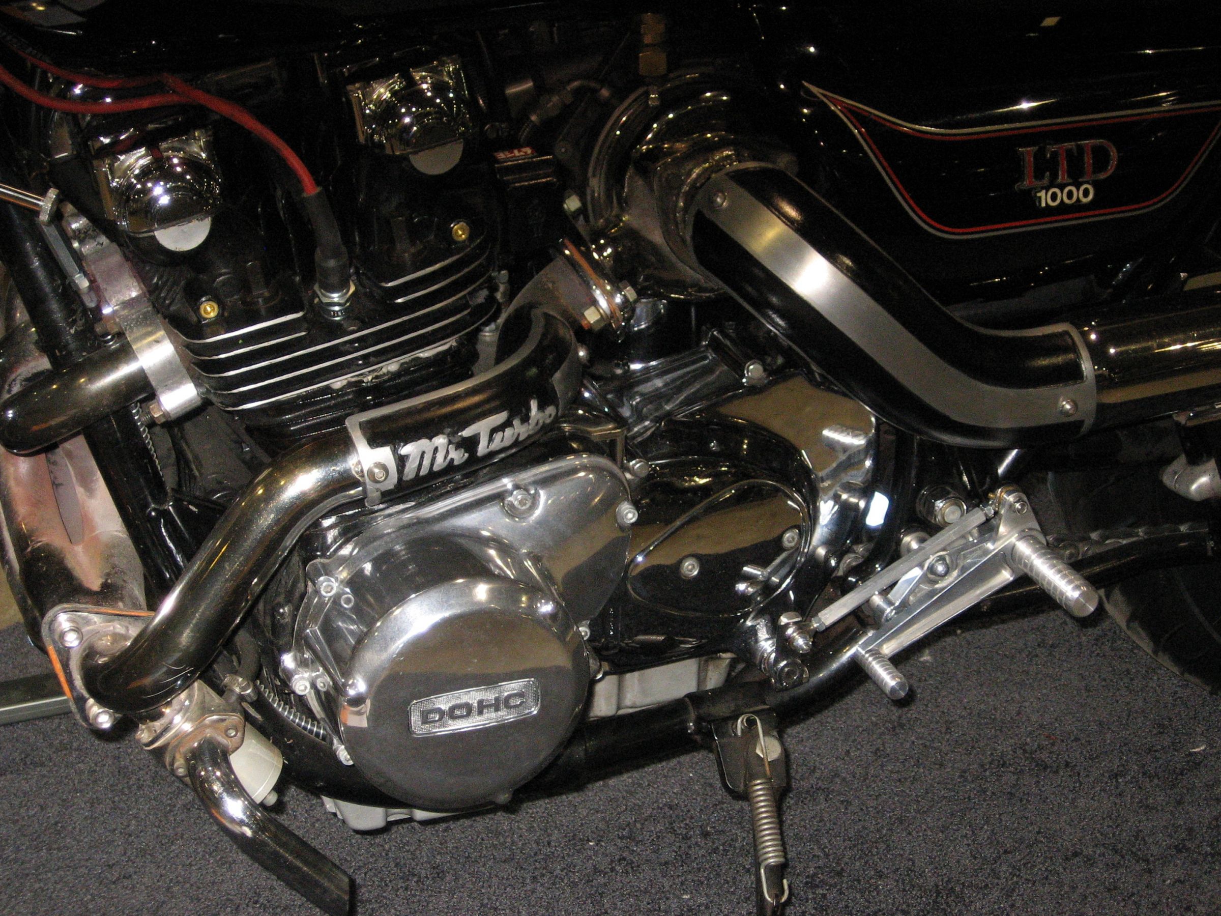

StreetFighter, your turbo'd monster makes me drool every time, and those rearsets are sexy as all get out, but they're just not the style i'm looking for. Les does some dang good work, and I'll employ his talent when I'm building a bike that fits the style. Those are just to simple for me, same with the Tarozzi rearsets. They look great, but just not what I'm going for with this bike- ultra-modern (picture an 80's cyberpunk anime)

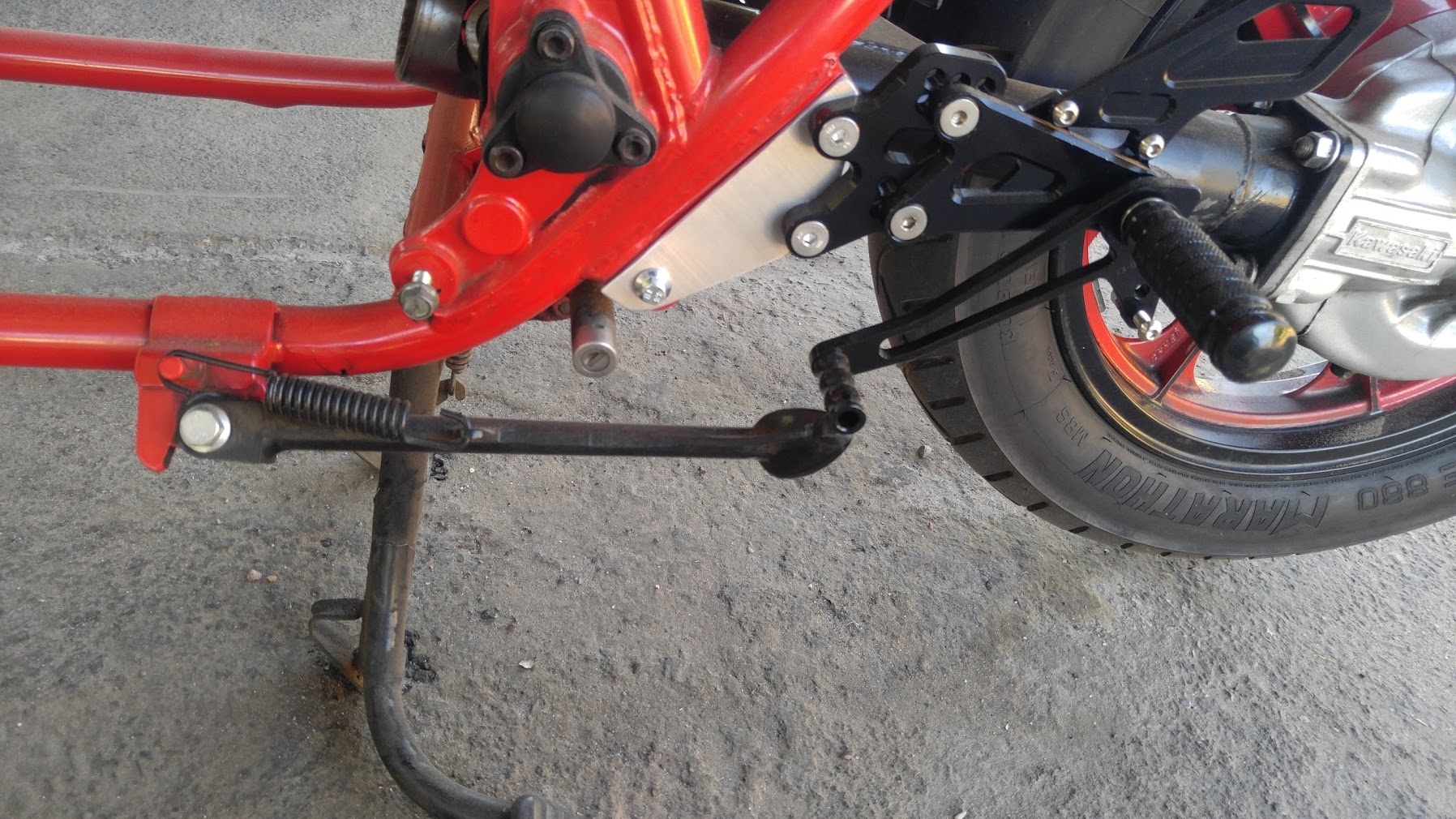

These rearsets came off a 1997 Yamaha FZR1000. I fabbed up some plates and custom control rods then stuck them on my ELR clone, Cost was $100.00.

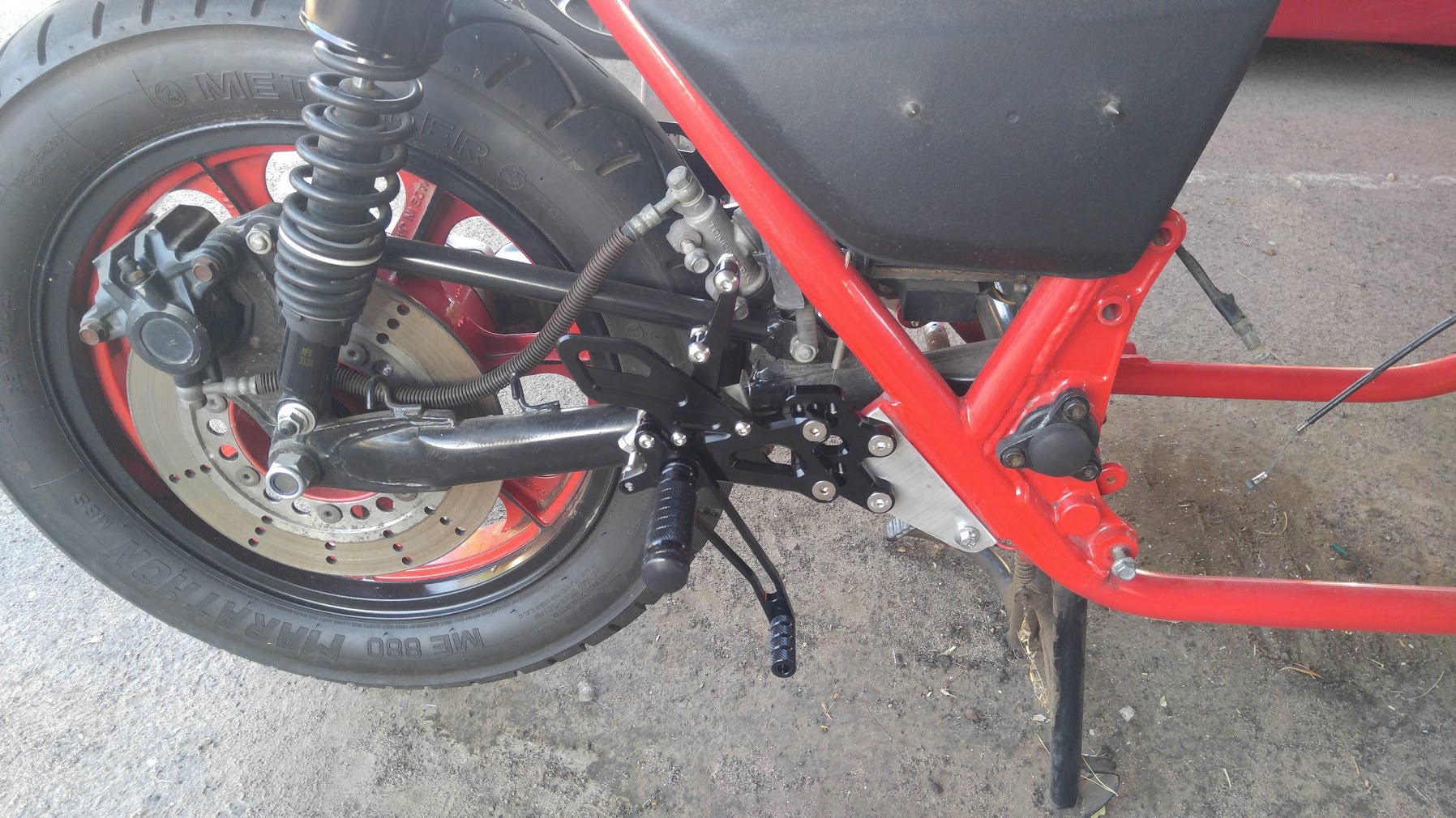

Well the ZX10R rearsets worked out well. Going to have to move the kickstand forward a bit but that's OK.
