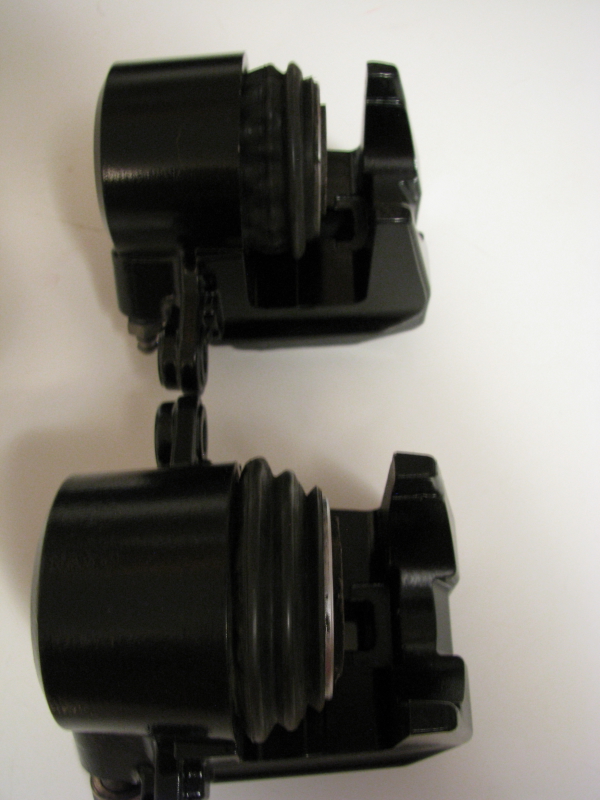

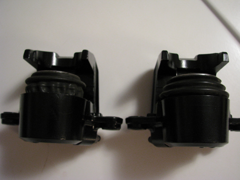

OK, I got pictures! Focus is a bit off, but hopefully everyone can see what I'm talking about...
Look to the outside edge at the top of each piston. On the right side, it looks like another accordian fold, while on the left side the top of the seal sits nice and flat inside the groove in the piston. The left is the original position of the dust seal.
Same this here... the brake closest to the camera has the top of the seal pushed out. The brake further away is how the dust seals originally sat in the piston.
So what is the trick in getting the end to sit properly? Or is this just some weird thing that they do naturally over time? Is it even important that the top of the dust seal be completely snug to the piston, or should I not have to worry about brake fluid coming out behind the dust seal (under normal circumstances)?

Re: Brake piston dust seal
31 May 2016 20:02
What do they look like collapsed?
31 May 2016 20:17
Pretty much the same. I closed up the pistons and then opened them back up again to see if they would seat, but it didn't change anything.
01 Jun 2016 11:20
@swest: it's not stretched out, the rubber is still very pliable and sits tightly against the piston, so I didn't think that was the problem.
HOWEVER... I think I finally figured it out. I noticed differences in the pictures last night that I hadn't recognized before. After I took out my contacts, I got a good up-close look to compare the two brakes. One of them has had the dust seal replaced, so they are not the same between both brakes. And when I rolled out the lip of the seal that I thought wasn't seating correctly, I realized it actually has a flat inside edge set at an angle... the the seal really IS seating into the ridge correctly, it just looks very different from the other brake, making me think something was wrong!
So, apparently, crisis averted. I guess I'll go ahead and put them on the bike and just deal with problems if they occur.
Thanks everyone for the help.
