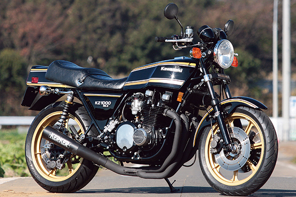

Don't try to put a 150 on your stock rim. The tire manufacturer may list it as possible, but the tire will just be squeezed upwards and it will not be allowed to take its intended profile. The tire beads may also not seat properly. I put a 150/60-18 tire on my Zephyr 550 3.50 rim and it just pushed the center up and still measures 140mm wide. The stock tire was 140. And the Bridgestone website showed it was a approved rim width for the 150 tire.
The cheapest route is do as you have done and find a Kawasaki wheel that is kinda close to matching the style of the front stock rim, or to buy matching front and rears.
The expensive route is to get a PMC 4.75-18 rear rim from Japan. They are made to look just like Kawasaki wheels, only much wider.

I read about the cracking rims when researching widened wheels.
The PMC wheels look nice, bit still don't match the stock seven spoke. A closer match might be these, but I'm not spending 1200 on a wheel. www.rolandsands.com/blog/452/morris-line
I would love to find wider Kawasaki wheels, bit to the best of my knowledge they never made similar wheels any wider than 3".

Good point..PMC sells 7-spoke MorrisMag magnesiums as well. They look real nice, but are stupid expensive.
