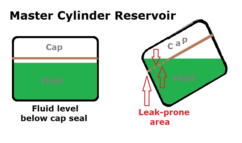

Depending upon the bars, there may not be room for the turn signals & the Fr Br mc may sit at an angle. The first thing I did was move the turn signals to the headlight bucket, installing stems in place of the big headlight bolts & replaced the tiny grounding rings with 10mm rings from the auto parts store (same size as the stems). Install the new bars first before ordering any cables or anything.
Bars & master cylinder. I originally installed Flanders med tall street bars, but have since gone with emgo european bars from Z1Enterprises.com. The flanders gave an upright riding position which was comfortable around town but no good at high speeds, especially for extended periods. the mc was fairly level. With the Euro bars, the mc is tilted some. with superbike or drag bars, the mc would sit at a steep angle. some guys go ahead & ride with it that way. New mcs that aren't too pricey are available on eebbaayy. usa-motorcycles-inc is one seller. I'll probably get superbike bars when I replace the mc.

Its a great idea.The handelbars were the first thing to go on my CSR (and the seat) but I went with a full on front/back conversion so I cant tell you anything about the cables. One thing though is,if I remember right,The front brake lever/master cylinder set up is at an angle because of the big bend in the bars.If you put on straight(er) bars the lever will sit squiffy.You may need to buy a new master cylinder.

May also need to replace the front master cylinder so that the brake fluid will usually be "level" without touching the gasket (which will eventually leak).
