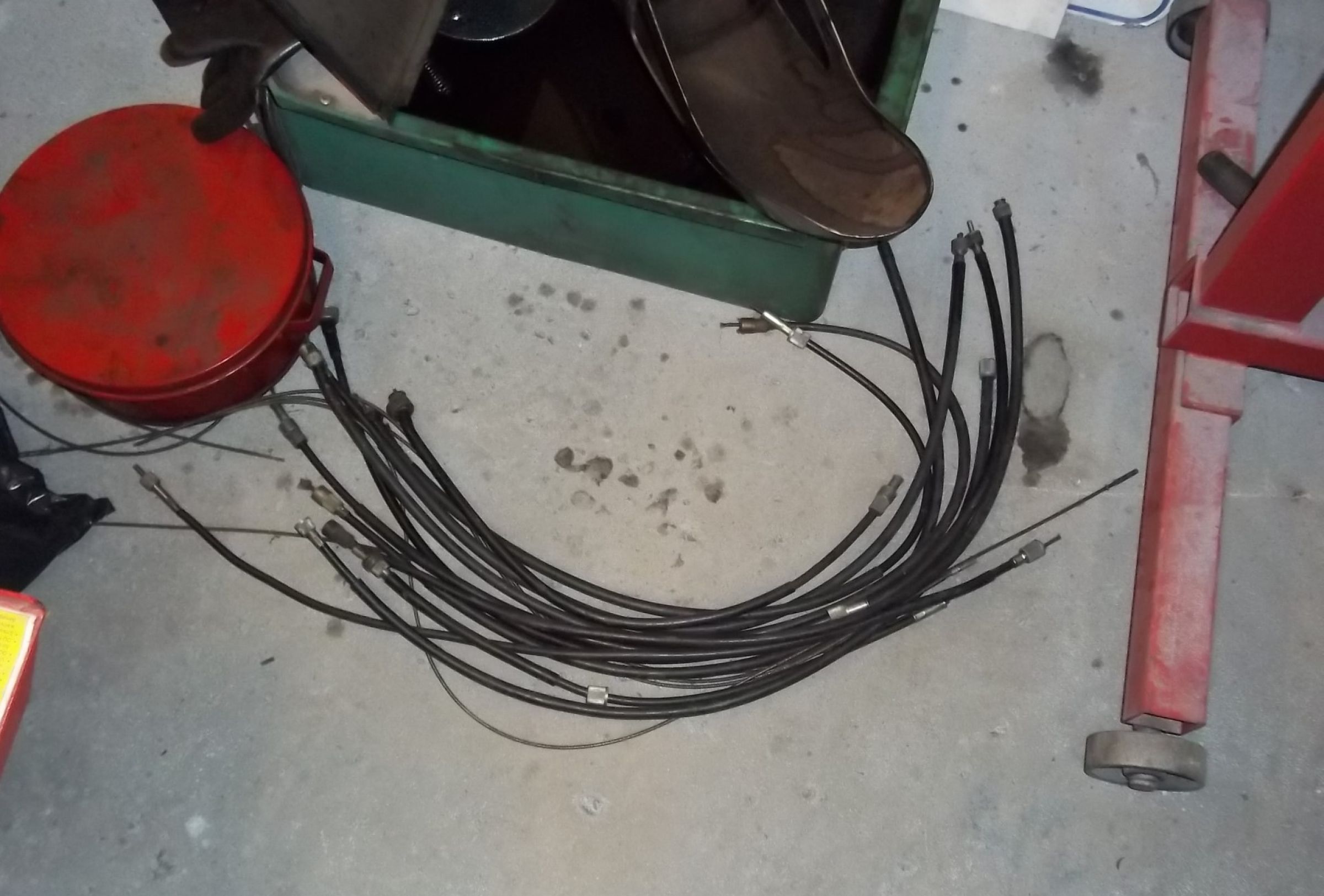

I have a pile of different speedo cables. from Z1's - KZ's & J models.

- TheNinj
- Posts: 10
Re: Speedo drive/cable thread sizes
04 May 2016 01:10 - 04 May 2016 01:11
I think the cable I need is 90cm long with an 11mm top thread and 10mm bottom thread.
The only cables I can find that length are either 11mm both ends or 10mm top and 11mm bottom! I've just ordered one and im hoping I can switch the inner around to fit!
